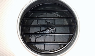

The plastic handle of the left air vent broke while the interior of the car was being cleaned at a car wash last weekend. I guess the cleaner had applied too much force while cleaning that area.
Can anyone suggest how best to repair this? The vent is currently stuck in a closed position.

That's pretty expensive considering the purpose is to change only the plastic part, not the entire duct.
Found out the part details from the site below which confirms the entire duct is worth 700/-.
Hyundai Grand i10: Central Facia Panel
1 x Duct Assy-Ctr Air Vent Lh| 97410B49004X +Rs. 684
What i'm actually looking for is just the plastic part on the front. Any idea if its available? What is that part known as? Any part numbers?
Can Forceps/ Pliers/ Wire rods / Hooks/ Clips / Safety pin etc be used to force it back in position? better try all Indian Jugaads if you are to replace them anyways.
Yes, i was able to open the flap, using the edge of a key and fixed it in a particular position for air flow.
