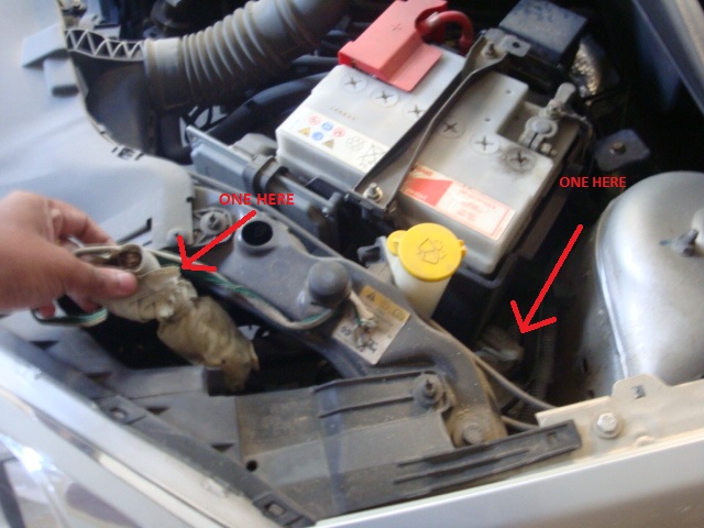

@Gurrala74, Here are few snaps. I wrap the tobacco in a cloth and keep in the engine bay. 2 of them hanging, 2 stuffed in the crevices.
This pic shows the 4 places. You can choose whichever place convinent in the engine bay.
Regarding where to buy: in a shop, where they sell all items required for temple puja stuff (campher, turmeric, sandal, agarbhatis, betel nuts, pan leaves, diyas etc). I don't know how to correctly explain.
You can ask for the dried tobacco leaves, and tell them it is for repelling the rats. They shopkeeper knows, generally people in small houses with the tiled roofs and the huts, they keep this tobacco leaves to repel the rats.
