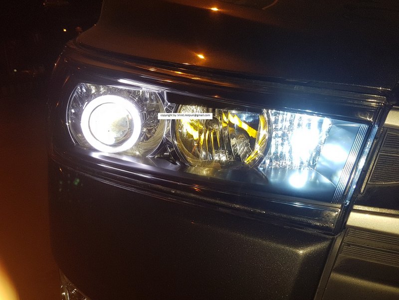

new innova crysta added projectors to stock headlamps
