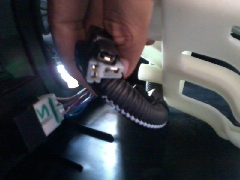

tried to fix ciggy charger.
opened gearbox cover but confused [frustration]
connections are out of my taste[evil]
can't find where to connect charger wires??
here i am attaching pic of socket
its sticked on same cable of power window .
The cigarette socket wires will go in the white socket in your picture. Just get suitable pins to go into the white socket. Don't cut the wires, lest it voids your warranty.
both wire in both white socket??
what about black socket? i think black should be for earthing.
