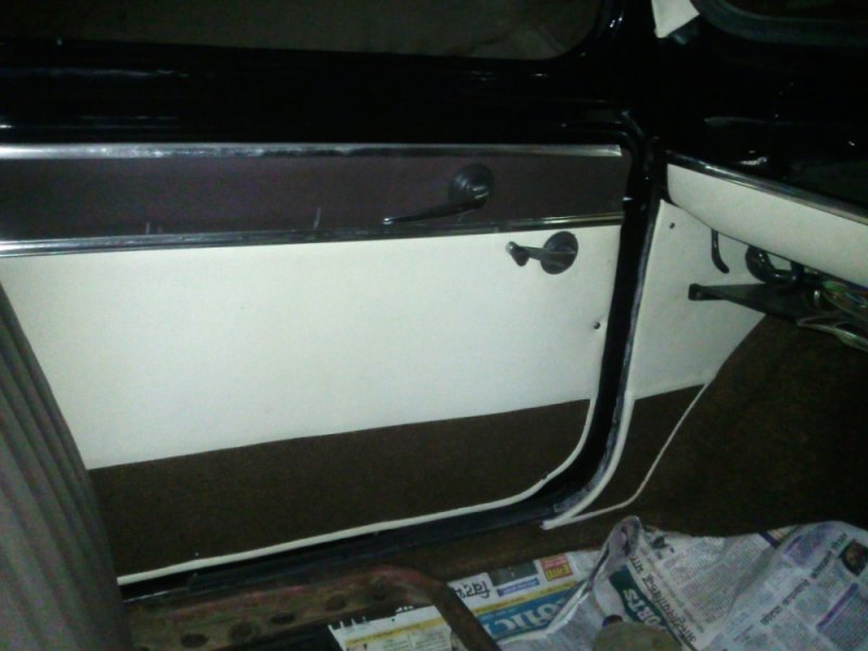

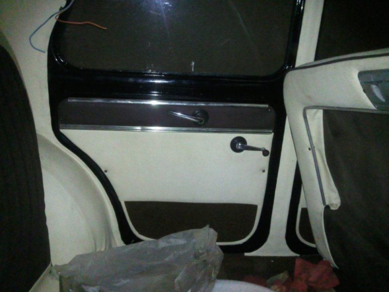

BTW I hope you are not going to mount the door pads with screws punched through the same, try using clips to fit it, will look far better & clean. You can get them fabricated or can look for them at scrapyard ( i have fitted door pads on my S1 using original clips & pattis that i pulled from various scrapped cars)

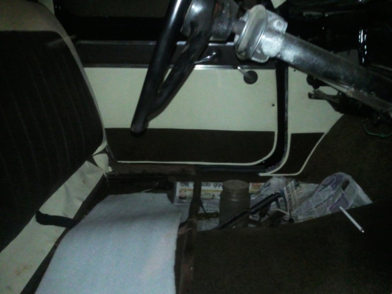

Cars interior are almost completed, here are some pictures of door panel, interior etc.

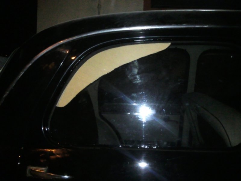

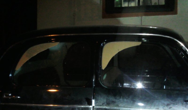

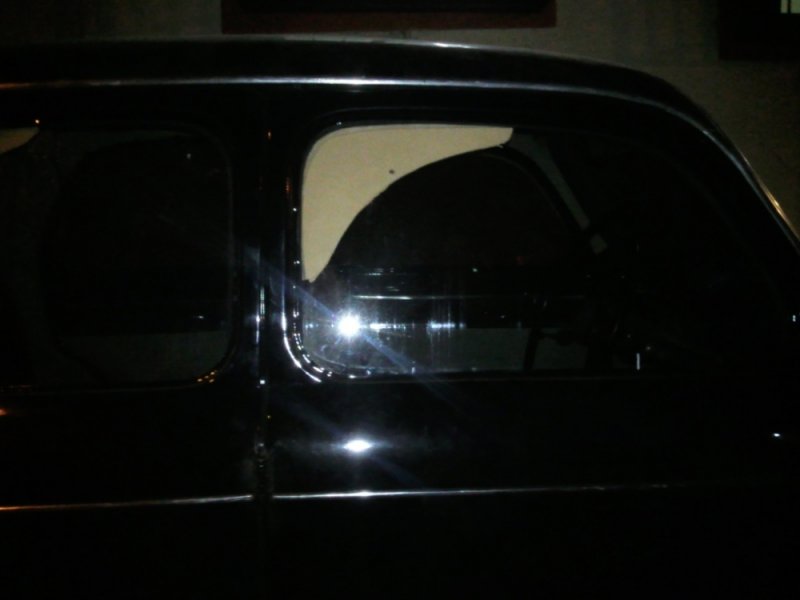

I made this from acrylic transperent sheet. Brown paper will be removed after installation.
