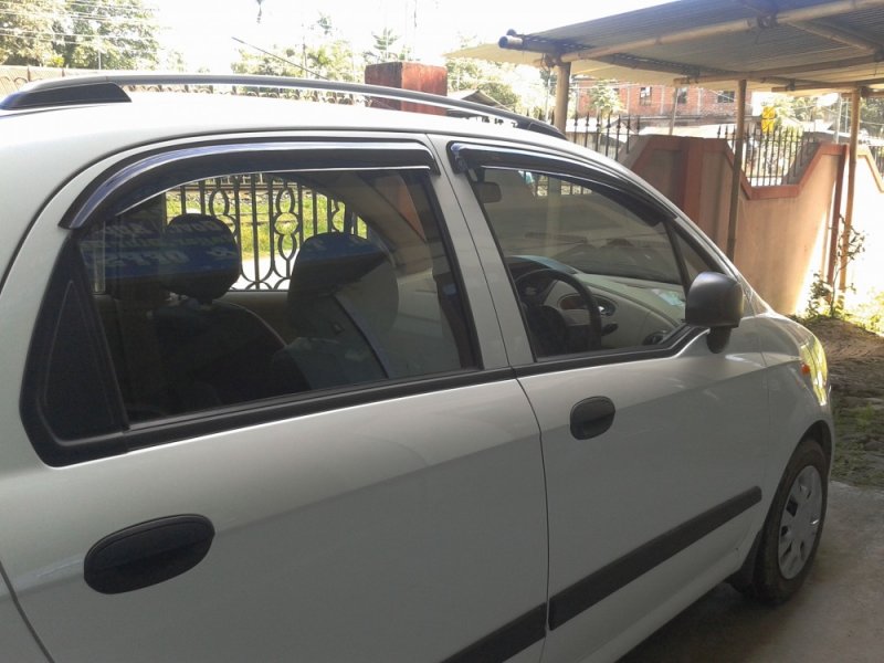

@Kannan, uploading a few pics of my spark with 70VLT Garware film for your reference. Hope it'll be useful.

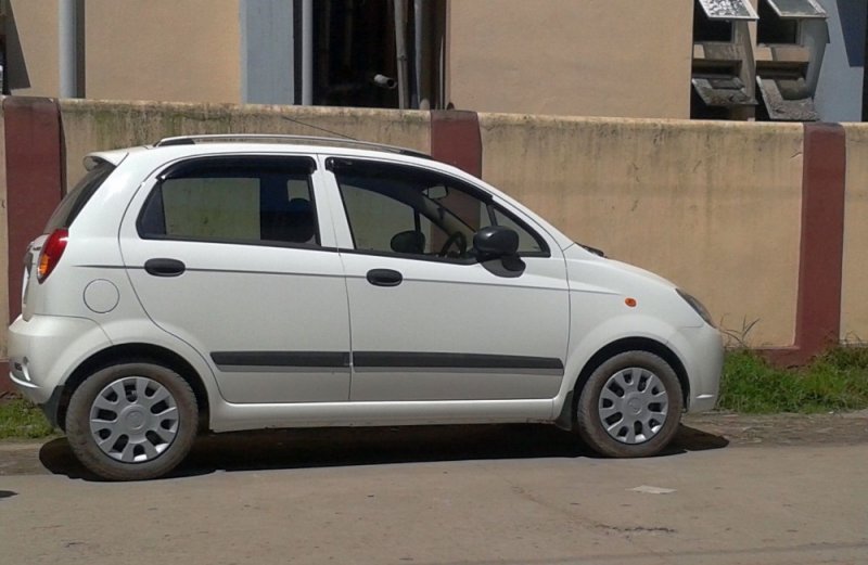

Friend your sparky looks great man. tell me one thing. is it okie to have 70vlt garware film instead of regular sun control film since court has directed nothing should be sicked to the windows. even yesterday i saw so many cars where doing this kind of stickers [transparent]. and will it reduce the heat from sun?

Thanks for the complement Sethu.
Well, regarding 70 VLT sunfilm, It may not be legal, but still if cops can see you clearly with all the windows rolled up, they may not bother to stop you. They are after real dark films. The whole thing is visibility. Yes, it reduces the heat to a bearable extent.

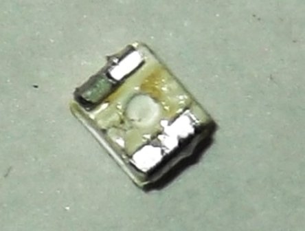

After searching few shops for LED bulbs I found a pair (9SMD)for Rs 300/- I decided not to buy it but make one myself. I had some spare LED strips at my home. 1 meter of non waterproof strip(60SMD LED) costs Rs 80/-
Presently I am testing the PCB for durability. Details of the final product will be posted soon.
The LED Strip
+ve and -ve terminal of the SMD LED
A single SMD LED
Soldered the SMD's on a PCB. I have used a thin tip soldering iron.
Sorry for the blurred pic
We can attach 5 SMD's in series for a 12v circuit.
Cost of one SMD Rs 1.30/- (if de-soldered from LED strip)
Cost of the PCB used for one bulb Rs 2/-
Cost of the solder wire/flux wires etc Rs 4/-
Total cost of a pair of DIY 5SMD bulbs will be Rs 30 appx.
