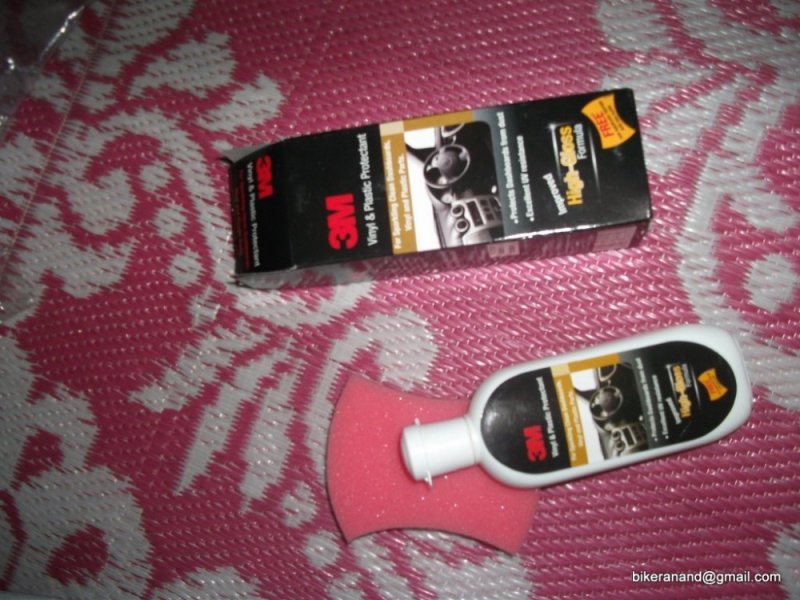

  4. Dashboard Polish (3M brand) - 107/-
I have Waxpol for exterior polish, bought this for polishing dashboard & other plastic items.
