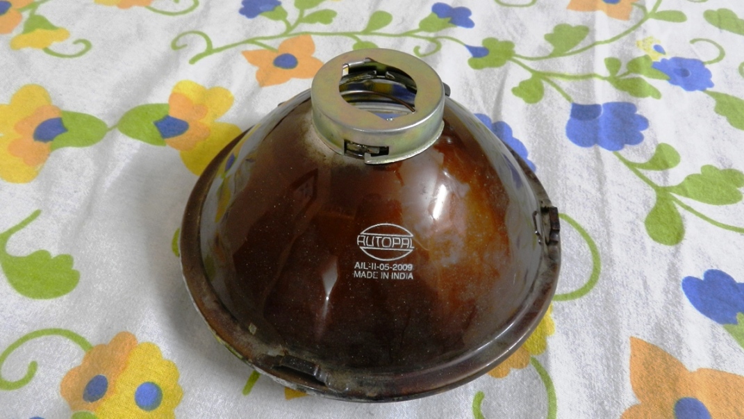

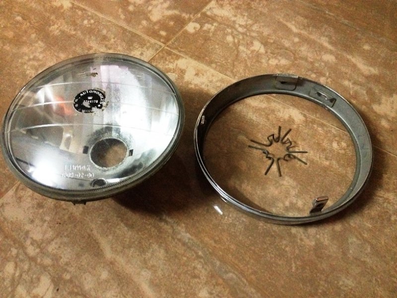

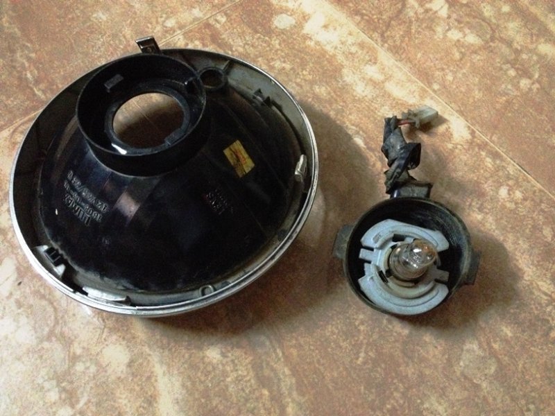

Got the HL reflector changed from OE --> Ambassador. This gives an advantage in using 12V 60/55W H4 bulb once when we upgrade the coil (very soon)
OE Reflector & HL socket
Reflector removed from the outer ring
Autopal 178mm reflector (for Amby)
Costed me 150 INR
This is how it looks
Found the reflector is cracked. It was perfect when I bought it.
After fixing this reflector to the OE outer ring, my poor mind went to super excited mode to test the out put and forgot to take the snaps [frustration] Let me post the final outcome and beam spread snaps tonight.
This made my pocket lighter by 300 INR
Reflector - 150
HL Bulb - 80 (12V 35/35W Osram)
HL Holder - 70 (Ceramic holder)

This is good. But original one came with clearlens type and in the photos it doesnt look it has any issues.
I'm not satisfied with the OE reflector beam spread (especially the Low Beam) May be I got used to the Amby reflector (which I'm using in my RX as well)

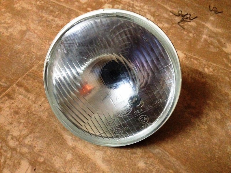

There is also a clear lens reflector available for Ambassadors, still this once looks nice and gels with the current looks
You mean this reflector?
I have them already, but that doesn't house the ordinary H4 bulb (this one uses some round basket like structure & the pins same as H4. Finding 12V 35/35W bulb for this holder is bit difficult, if I postpone the idea of coil upgrade)

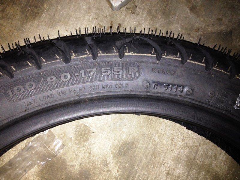

Settled for CEAT Zoom series tires. Though there is a mixed review for these tires, I have a very good experience with them on my friend's Pulsar.
Front : 2.75 x 17 Tube type (Jan 2015 Manufactured)
Rear : 100/90 x 17 Tubless (Dec 2014 manufactured)
Few updates for this week.
Settled for CEAT Zoom series tires. Front : 2.75 x 17 Tube type (Jan 2015 Manufactured)
Satish, the project is really going to be an awesome one! Really love the amount of efforts put in and of-course immense R&D (My favorite[;)]) put in it. How will be the ride of the bike if it has one tube and one tubeless tyre? Is there any significant difference having 2 different type of Tyre(s)?
For 2 wheelers this shouldn't make any change in performance. Anyways, I bought the tube for rear as well. Since I settled for used alloy wheels, I don't wish to take the risk with tubeless scheme. Rear assembly is already fitted to the bike last night (late night) and the snaps are yet to be downloaded form my phone.
You are tempting me man. OK, added to the wishlist [glasses]
Yes, you are right. This type of bulb is called H4 P45 type. The other one with 3 tiny protrusions is called H4 P43 type. P43 type transparent reflectors are also available in market. Check at a truck part store. Should cost you under Rs200/- for a local made stuff.
