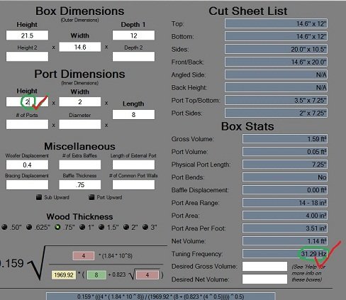

Use this software (from SMD forum) to calculate subbox size and to tune frequncy of subbox.
http://www.stevemeadedesigns.com/board/topic/38791-torres-box-tuning-calculator/
(link to download is on that page)
it works for ported box only
How to use -
1. you have to put height 1 , width and depth 1 in INCH in box dimesnsion
2. Put port dimension in INCH
3. put woofer displacement - usually found in sub manual (in cubic ft. - eg. I put 0.4 for my sub infinity 1260w)
4. select wood(MDF) thickness.
other Cut sheet list and Box stats will automatically appear.
Most important is TUNING FREQUENCY. try to set it between 20 to 40 hz by changing different parameters and then go and make custom made box.

btw I calculated my current subbox in torres calculator and it's currently set at 71 hz ... this is the biggest mistake I made in making a very big port.
(In 1st pic)
I am going to correct it by closing almost 9 inch of port , ( height- 11.2 inch will be changed to only 2 inch ) , and what will be the result see in 2nd pic.
it will be tuned to 31 hz frequency. best for equal amount of punch as well as boom.
Any suggestions ?
I will close the red lined area (in 3rd pic) to do so
