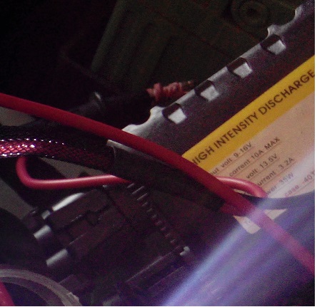

I have attached the Duster headlamp picture for your reference. I could go with HID fogs first, but would it make a substantial difference to the low (ground level light) ? I have a problem with the throw of the low beams. And yes, I have OE fogs.
Hello there!
1..if you're short on budget, upgrade the fogs first. they serve as second low beams and really enhance the safety. otherwise, it's better to upgrade BOTH lows and fogs at once.
2. I don't quite remember duster headlamps. is the black tint on the lens or just around the bezels surrounding reflectors? do remove any black tints if possible
3. the experience in rain is well documented in this thread before. however, as duster does not have projectors to control light beam, I cannot comment about spreading during Bad weather.
generally, HID = PROJECTOR.
if you drive a lot during rains, just upgrade to 3000k hid lamps in fogs and keep headlights stock.
p.s- I assume you have genuine oem fogs.
