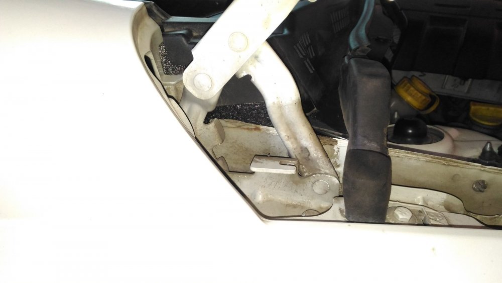

After a long time of Procrastination, I got my lazy self into Opening the XUV cowl area and take a peek inside.
I was pleased to see a lot of DUST, but thankfully no Rust!
So These are the Rat meshes that ASC had installed. And yeah they charged me 2k to install them.
Some Parts if wiper Motor are unpainted, and would have chances of Rust in Far future, I I painted them. Can you identify the Painted parts? I also lubricated the linkages with grease before fitment.
Now started the process of sealing the cowl itslef. Used closed cell foam (Neoprene) to seal the cowl cover itself. Used Rubber adhesive to apply measured & trimmed pieces of neoprene on all openings & Slats. This will prevent Rodent, Dust And leaves from entering the cowl.
Next was the seal the AC Air intakes. These are sealed with Rubber adhesive once and the gaps have been caulked out using neutral cure Nova Silicon tube. Do not use acid cure silicons on vehicles as it will eat metal in the long run.
Quite a nice seal I must say!
Also sealed the minor gaps at sides where rats would find easy entry. Now there is just no chance of rodent entry!

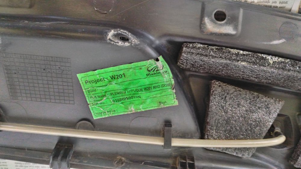

Yes, XUV 500 was called Project W201, W standing for WORLD.
P.s- Forgot to share images of marking tapes I used-
