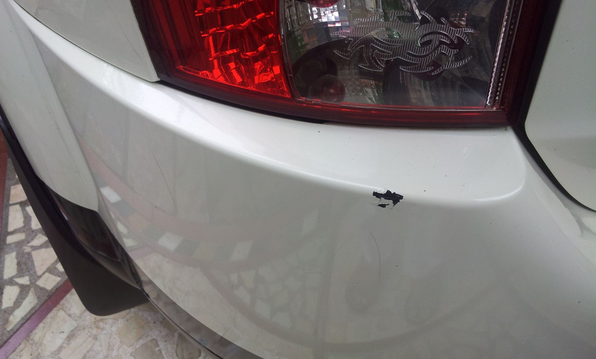

ODO 72k.
Nothing much to report.
Thunderbolt got a small paint chip due to errant biker. Can this be touched up?
And these pieces just fell when driving, So I pressed em into place. They are from behind IRVM.
