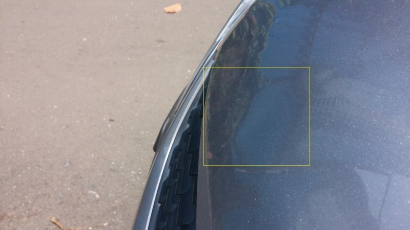

that dent is in the very tip of the bonet, just behind the front grille. Its in a place where the bonet is double skinned i.e. there is another metal frame on the engine side, so it was very difficult to access.
With regards to the scratches, Was wondering if brush paint touchup wouldnt look too conspicuous
Ok, for the hood dent, best would be to take a professional ASC advise. About scratches if your car is in solid colors like Dark Blue or Red then fine paint touching with a Zero-Number paint brush would be ok but only in deep ones not on finer ones. If your car is metallic shade like Dark Silver or Light one like Beige then paint matching for touch up will be bit tough. From a distance, touch-up in any paint will be noticeable.

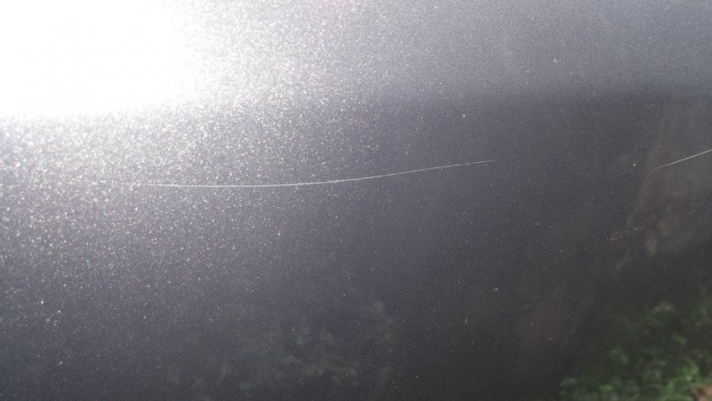

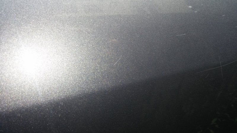

Those pics you guys were waiting on
For pic 1 and 2: Good buffing and detailing is needed.
For pic 3 Buffing + Touch up using zero number paint brush
For pic 4, I would say best would be ASC denting. Make them use soft end hammer and that ways, the original paint will not get damaged.

Fir both pics 1 & 3, you can feel the scratch if you run your finger over. I had a go with the Ciodo polishing machine as well as my hand, some Sheeba polishing compound & 3m wax. What you see is after that

If these scratches are on a very bumper or fenders, light compounding can be done and reduce the depth of the scratches, else might need a wet sanding. Or any polish or glaze with fillers can also be used.

I tried 3m polish & a polishing compound fently but there isint much effect on the scratch. I am told that com paint has a very close colour match. Still i will first use on the bumper which has a scratch as well but isint that conspicuous. Will follow up with light rubbing compound and see
