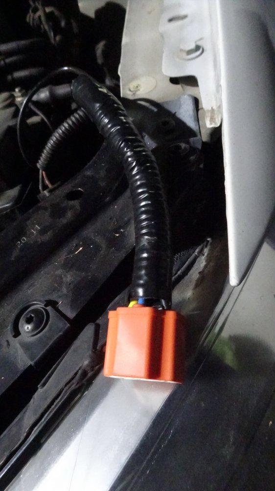

The other headlight bulb holder conks off. Got Roots this time.
Roots Ceramic Bulb Holder - ₹ 83.00
Installed with flexible hose.
