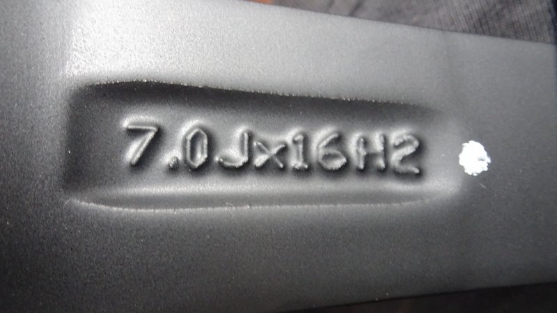

7.0Jx16

Offset 40.

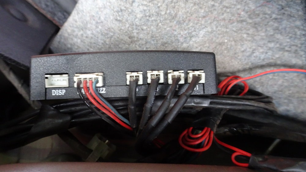

Accidental discovery, Autocop reverse sensor.
Installation was pretty straight forward. Remove beading.
Pull off the carpet.
Four 10-mm nuts and it comes off.
Cleaned up and installed light, just the reverse procedure.
