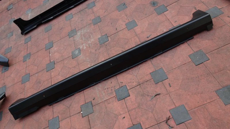

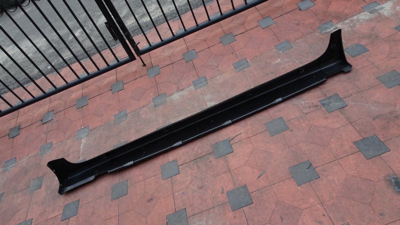

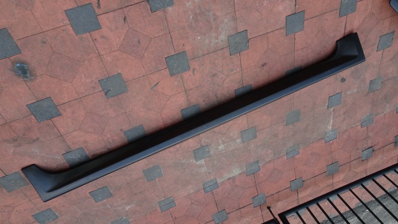

Running board cover
Panel - LHS 8A39-16441AJXWAA ₹ 4,570.00
Panel - RHS 8A39-16440AJXWAA ₹ 4,481.00

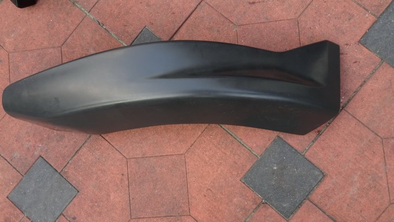

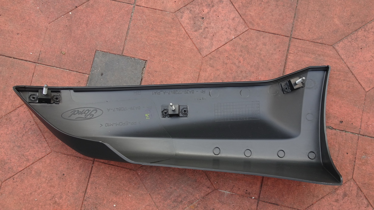

Rear Bumper Cover
Bumper Aero Shoulder - LHS 8A39-17G847-AA ₹ 1,795.00
Bumper Aero Shoulder - RHS 8A39-17G848-AA ₹ 1,795.00

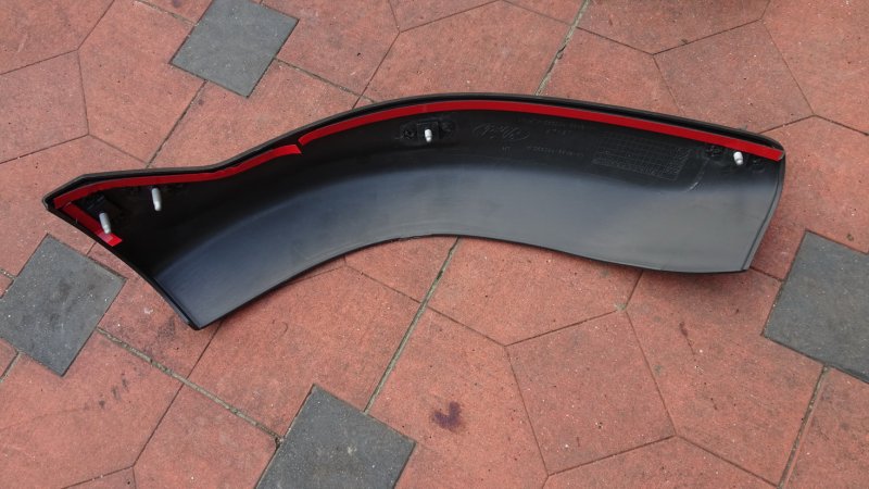

Front Bumper
Front Bumper Cover Kit - LHS 8A39-17E995-AA ₹ 1,899.00
Front Bumper Cover Kit - RHS 8A39-17E994-AA ₹ 1,860.00

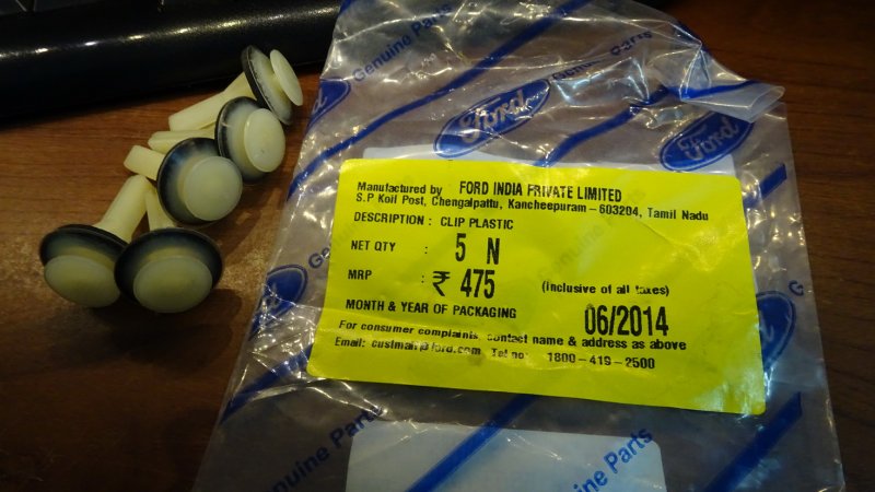

Plastic Clip (5 pieces) 8A39-F15503-AB ₹ 475.00 x 2
For mounting running board cover. Have to drill running board.

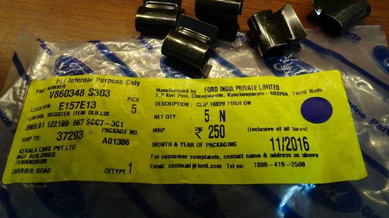

10x20 Push On Clip (5 pieces) V860348S303 ₹ 250.00 x 2
For clipping running board cover to running boards.

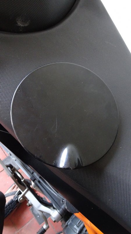

Fuel lid cover for color matching.
Pop the notch
And slide out.

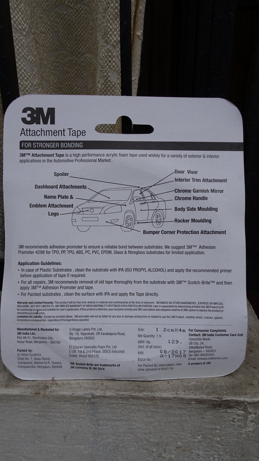

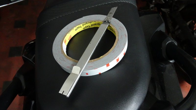

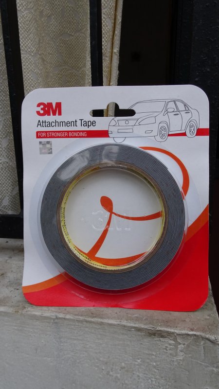

In the 3M tape I believe. ₹ 129.00/per roll MRP, got for ₹ 120.00/each. Available at Rajam Paint, near New Theater. Got 2 rolls.

^^ Running board kit was stuck with 3M tape at door sills. Front secured with wheel liner clips and to running board weld joint with provided metal clips.

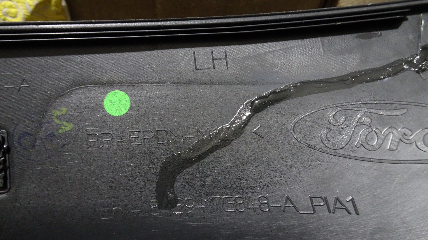

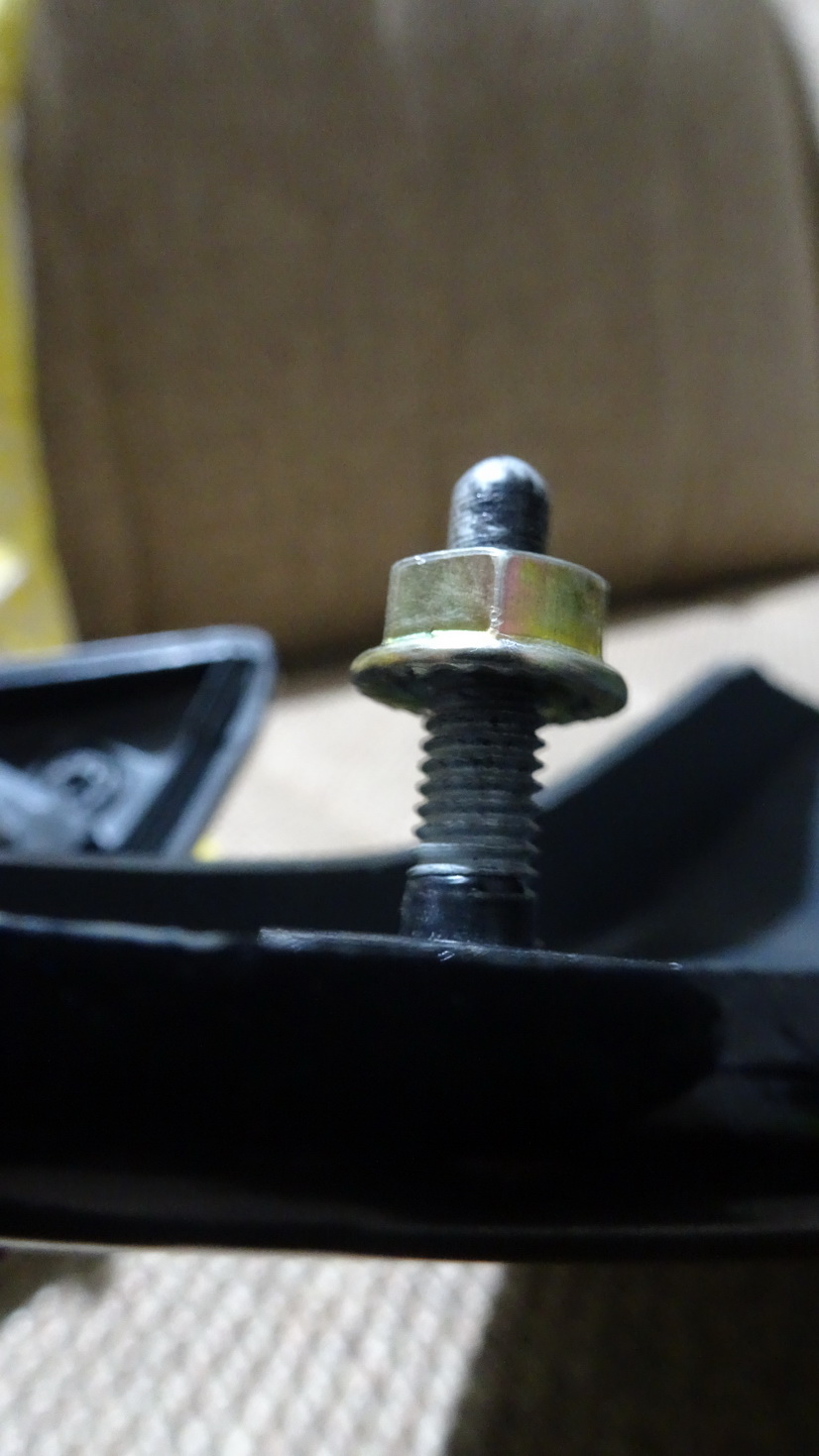

Grave QC error from Ford's side, on rear kit.
First, wrong side marking.
Wrong mount. There were 3 mounts. Edge ones were supposed to be flush with the kit and middle one was to bulge out. All 3 mounts were bulging, making fit impossible.
Cut, sanded and bathed is superglue. Strong flat mount.

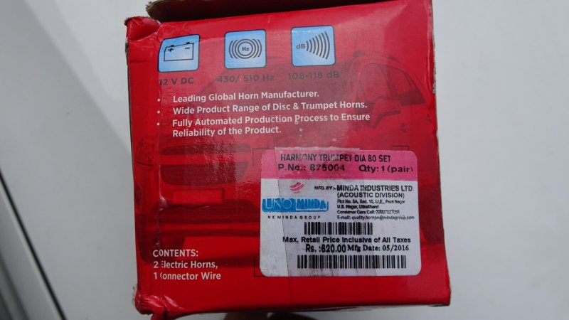

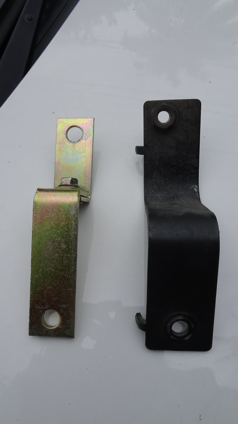

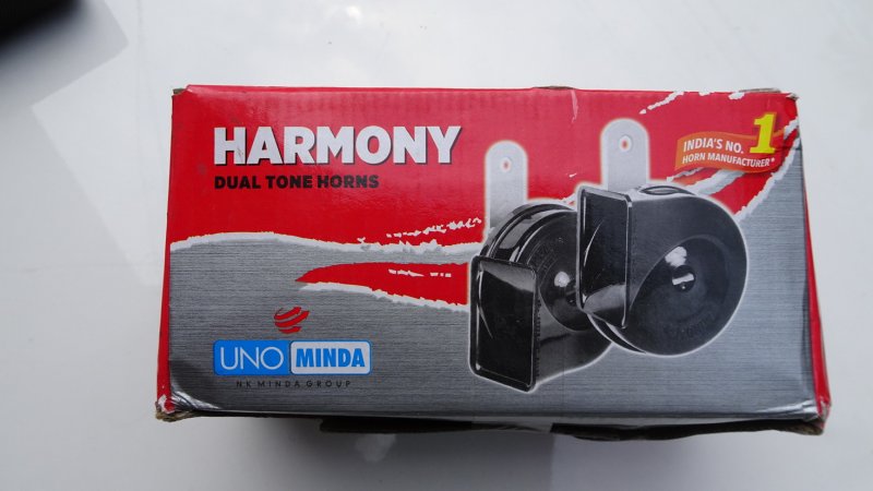

Bought a pair of horn. Minda Harmony for a change. Install went side by side with kit install. Bulkier than regular Bosch/Roots Windtones. Sound is premium bassy, but harsh. MRP ₹ 620.00 plus ₹ 50.00 for L clamps.

Custom clamp (2 L clamps combined) & OE clamp for symmetry.

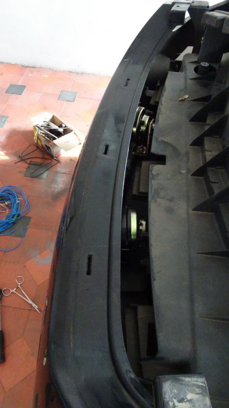

First tried removing the bumper for clean kit and horn install, but number of bolts and their weird location, made me think twice. Ended up removing headlights, which made is so much easy.

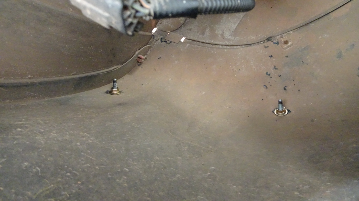

Kit bolted. Front ones need either underbody protector removed or headlight removed for install. Rear is easily accessible under without removing anything. Bought a tonne of 10 mm flange bolt and extra washer.

Not symmetric as expected. Will change the OE clamp with twin L-clamp combo ASAP. Removing the bolt behind number plate loosens up bumper a bit, leaving enough room to work around, its a torx bolt.

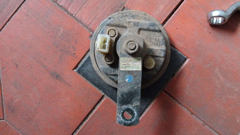

Googly. Horn connector turns out to be mini clips.
OE horns were FIAMM make. 9A each/pair, making things lot easy. Minda was 10A/pair.

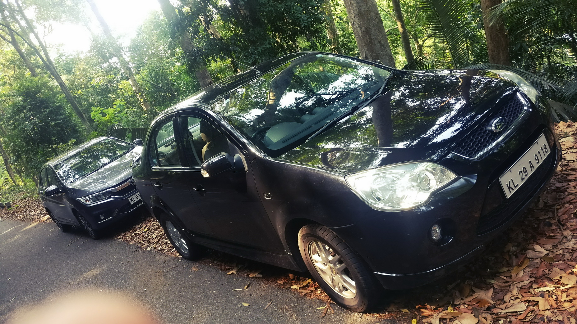

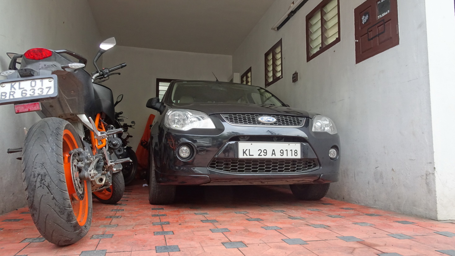

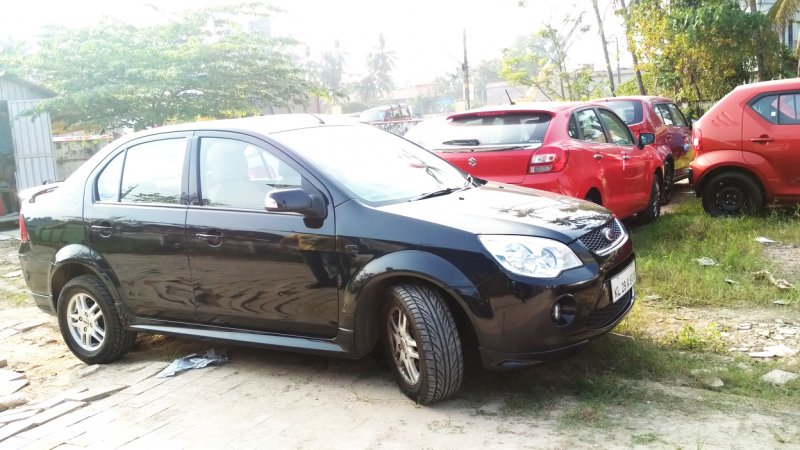

Final outcome [evil]
The template car. Vichu's 1.6, without which bumper kit install would have been impossible. Was counting stars after screwing up the rear bumper with holes through its length and breadth, just before calling him up for rescue.
1.6S got pre-holed bumper. Seen many Fiesta's with added kits and all looked weird because of the improper install. Understood after trying that it is impossible to fit without an S for reference. Trial and error wont work out. Kit is kind of floating with only top part in contact with body and bottom free. Most try matching bottom with bumper edge and then drill hole, which makes it really odd.

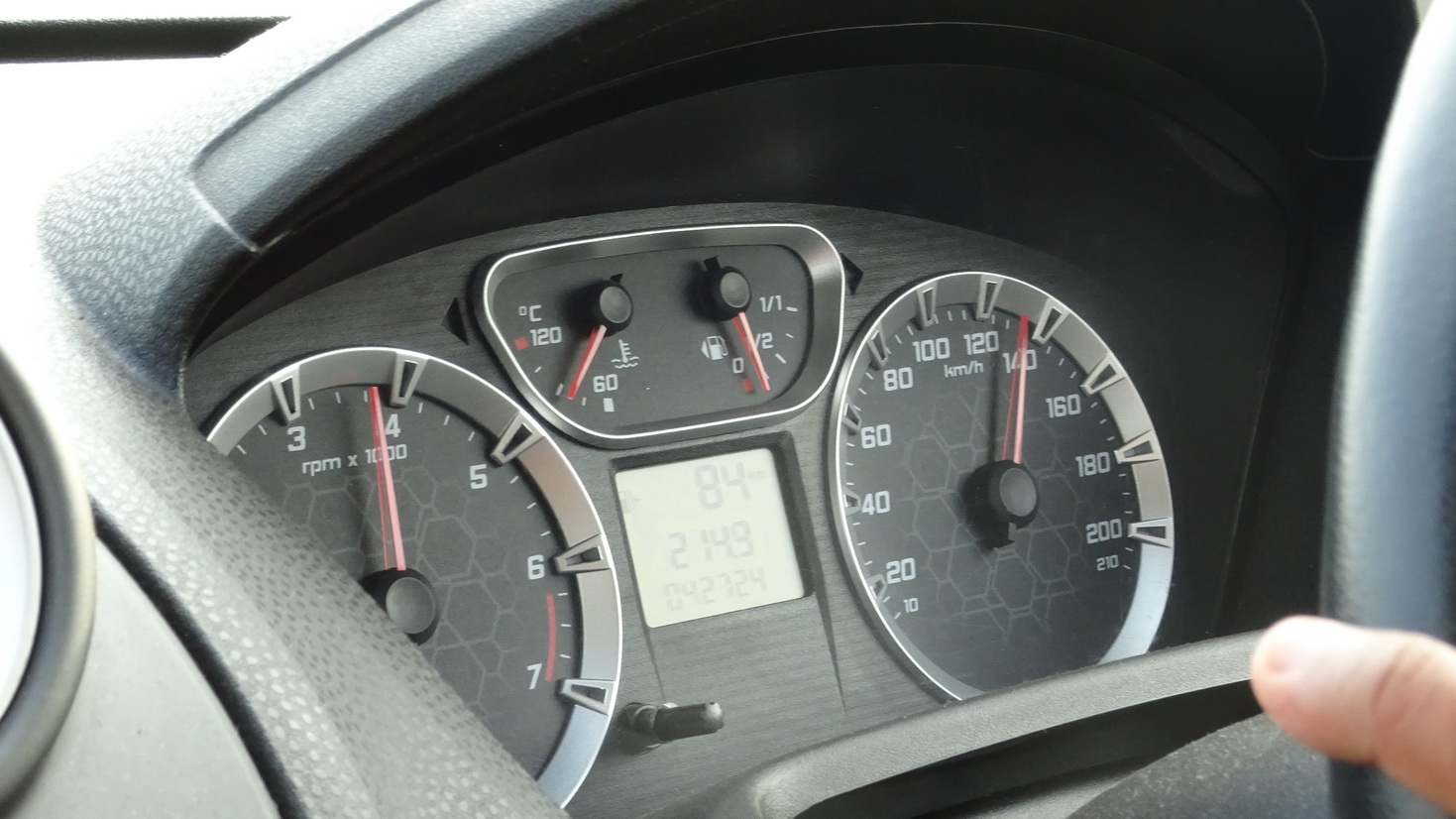

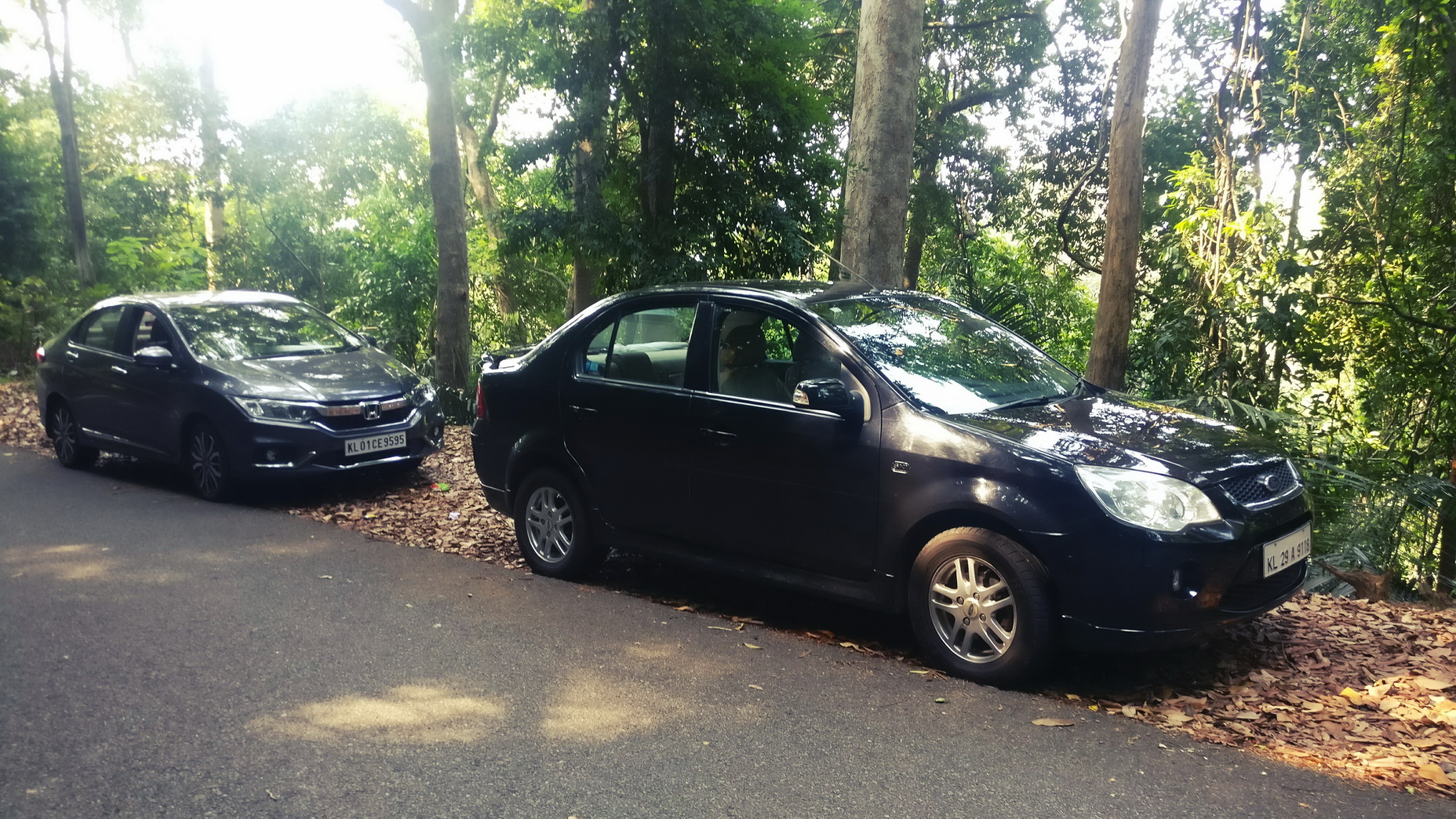

Been our highway car for past few weekend trips.
Cruising 120s was ease. Could do 140 effortless, even more. Mileage was 11-13 kmpl.
