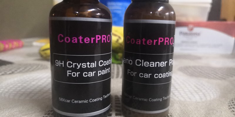

Post monsoon i wanted to do a proper professional round of polishing/coating.
I have been seeing a lot of 9h ceramic coat advertisements - but excruciatingly expensive - so i decided to buy off aliexpress something that is popular and give it a try.
I ended up buying one set of 9h stuff and one set of 10h stuff - if you aren't familiar what 9h or 10h means , please refer to below link - basically its a qualitative scale for scratch resistance. 10h means equivalent of a diamond! Do check the absolute scale too to get a comparative idea. Its like a hard glass coat over the whole car.
https://en.wikipedia.org/wiki/Mohs_scale_of_mineral_hardness
But remember the harder it is - the more difficult it is to apply.
The process to apply is to first prepare the surface as you would in any polishing process including claying/rubbing/ polishing etc and finally you apply the coat and buff it. There is a specific process to do that and it takes about 24 hrs to cure after which you apply a maintenance coat.
The product claims it to be lifetime especially the 10h one - but only time will tell :biggrin:. Initial impressions are very good, the water beading capability and hydrophobic nature is a boon especially when you want to clean cars - one more point to note is after this coat dont wash the car for 7 days and thereafter use a ph neutral shampoo. I wont try out the scratch resistance myself, but surely the Pune 2 wheeler riders will give me that joy shortly [frustration].

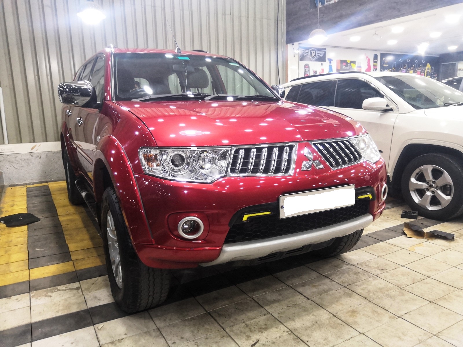

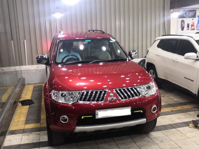

Some pics for visual joy - the vehicle looks brand new nearly and its 5 years old now!
In the PS I applied the 10h coat - Vcross is next!

Amazing Job IR,
Paj is gleaming like anything.
Did you apply the coating as a DIY? If so do share the process and secrets of application.
BTW Paj has a 2wd/4wd indicator in the center dials itself. Showing its emphasis on offroading! very nice.

Thanks bhvm, it was semi DIY, I listed out the process and the boys did it at a detailing outlet (ex 3m guy). Once the surface is prepared and all polishing is done, this coat is to be hand applied. To be honest the first time we tried we had some difficulties as 10H coat is very hard to buff, the trick is to not wait much and simply buff.
Please check this video, i followed a similar process. This coat basically seals the entire surface and forms a protective hard glass like surface - so has to be done after surface is effectively cleaned and polished.
https://www.youtube.com/watch?v=2x_pYJNWOk0
@ Kinshuk i figured an inexpensive way out, bought it off aliexpress and did it at a known guys place - please see above video for application, surface preparation etc you are already an expert - this step comes at the end of it, clean it with a polish, spray a little water, use the liquid and spread it panel by panel and buff it off, let it cure for a day and go a maintenance coat and buff that off too immediately. This application doesnt require a machine, but the previous steps before this, buffing machine is good to have.

No not needed - once applied this thing hardens pretty much immediately, just apply on a small panel area and within a min buff it off (depends on ambient temperature) in the area you are at. Just google other 9h videos too - the basic process is the same for 9h and 10h - only difference is 10h hardens faster and you need a good applicator who follows the discipline of applying and buffing.
