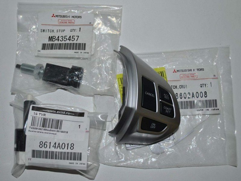

Since our Pajero Sport is CKD and imported from Thailand, i bought the part from Thailand(i have part numbers with me for brake switch and steering module and yes you also require the clutch switch) - having it all OEM is the best option than after market CC in my view.

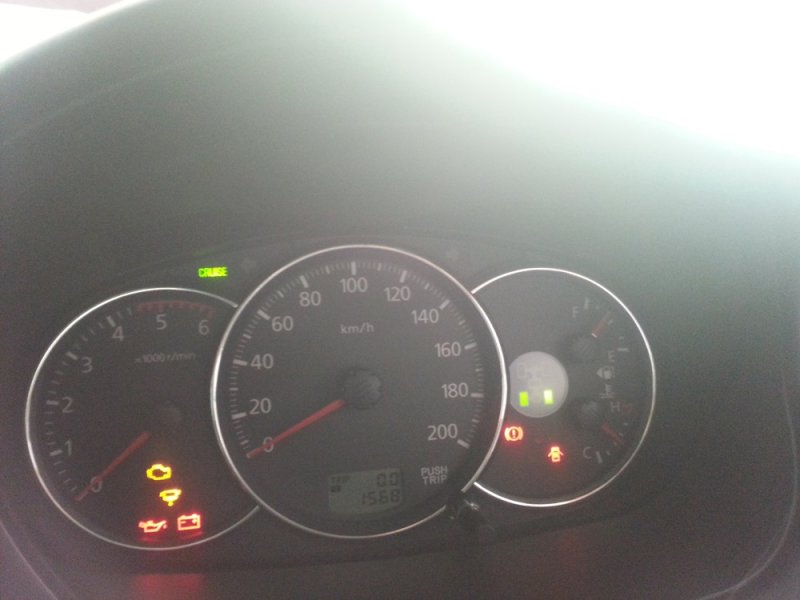

Put the ignition key and keep it on on position. Press the on/off switch once and viola you will see cruise control green light on the dashboard - that is good news!

All 3 components pictured - photo courtesy AG again.
