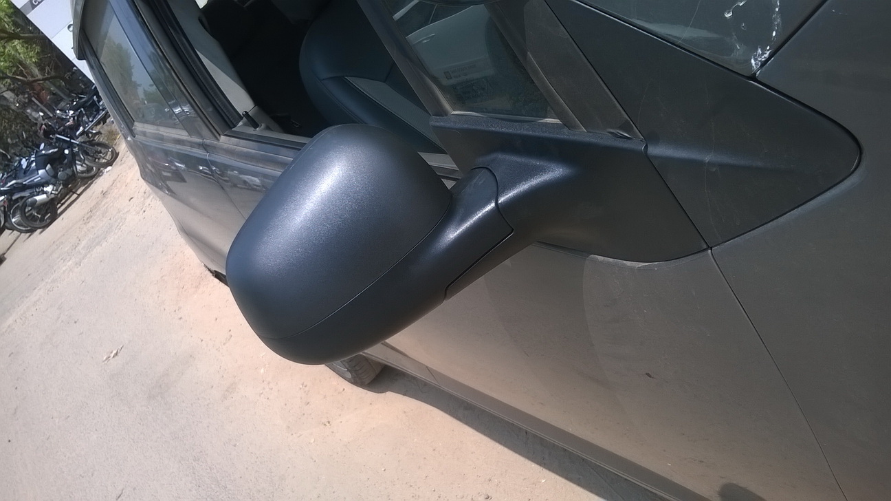

Changed mirror assembly again. I believe the 6th one [frustration]. This time a VW Polo knocked it down. Last 3 were duplicates as Chevy was not selling OE spares outside and don't want to go up to Chevy dealer. This time changed at Chevy. Entry-Work-Bill-Exit happened in less than 30 min and total bill was just slightly more than the duplicate mirror.
Bill:
Mirror - 1317
Installation - 75+T
Total - 1400
