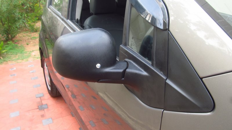

Broken mirror case. By the old reckless pulsar guy. It was brand new mirror. That part will fall off with slight impact and missing in most Beats. This time the adjustment mechanism was also damaged. Bought new one for 1.2k, duplicate one with convex mirror.
No need to remove door pad, thank to Chevy. Remove the flap.
Remove the cover.
3 bolts and it comes off.
New mirror. Luckily single piece unlike stock, so no fear of losing cover again.

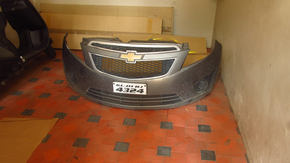

The bumper.

Foglamp pod, front view. Removed from bumper.

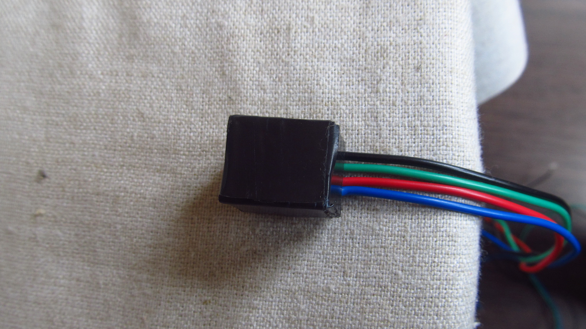

Sleeved, wired and tied.

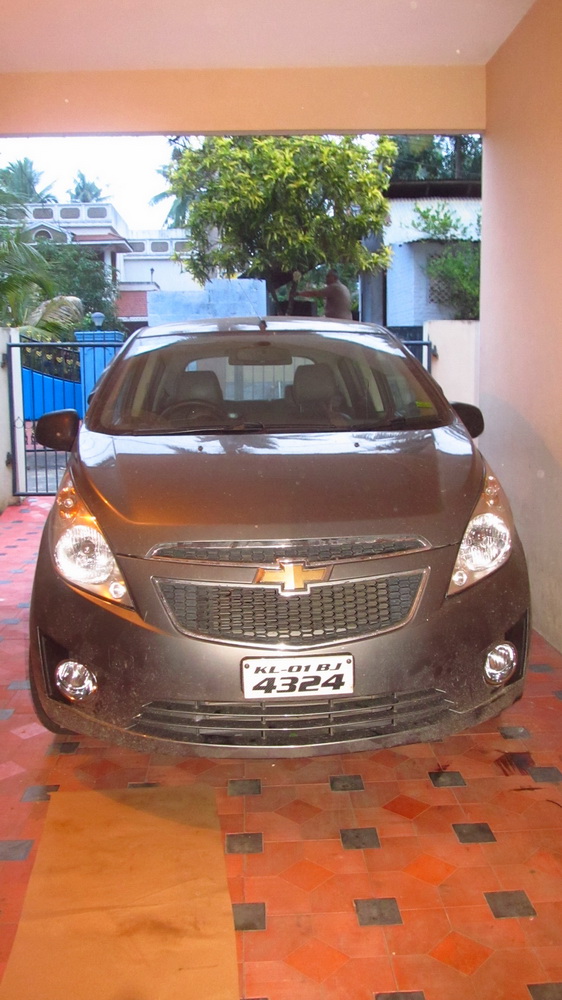

Final look after install.

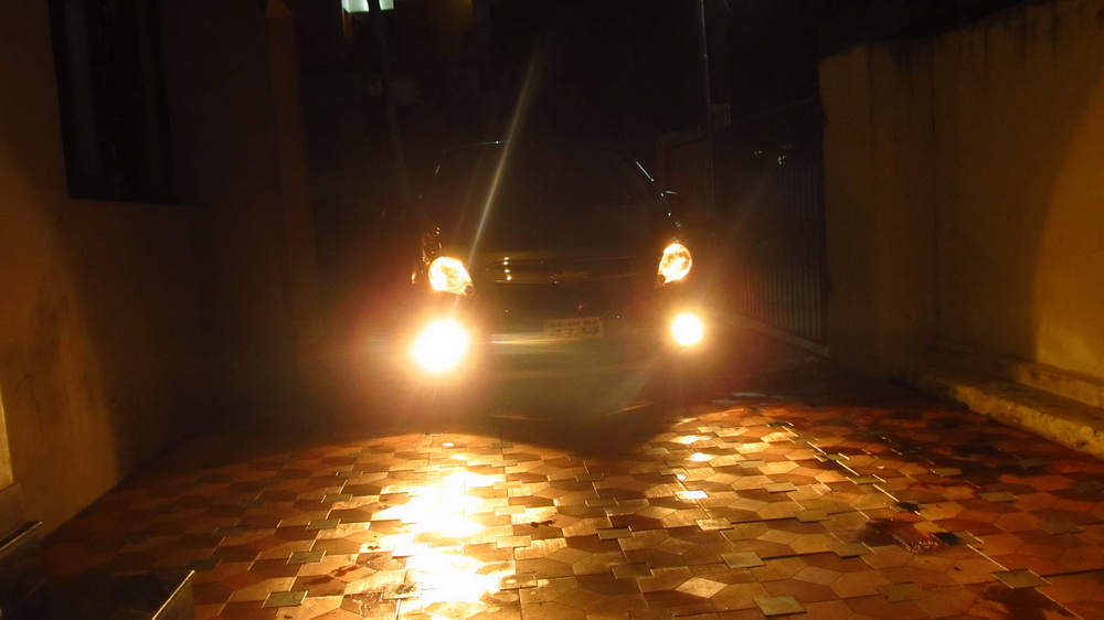

Light throw in dark.
