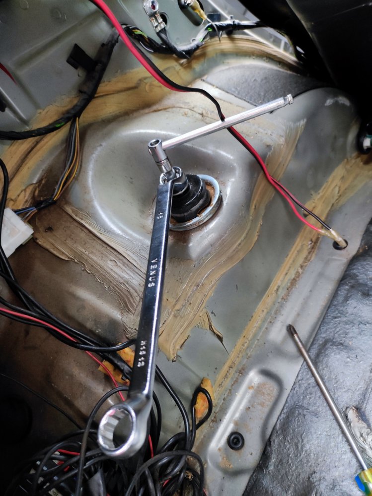

Access to the shock mounting.
A 6-mm socket to hold
and a 15-mm ring spanner to loosen up the nut.

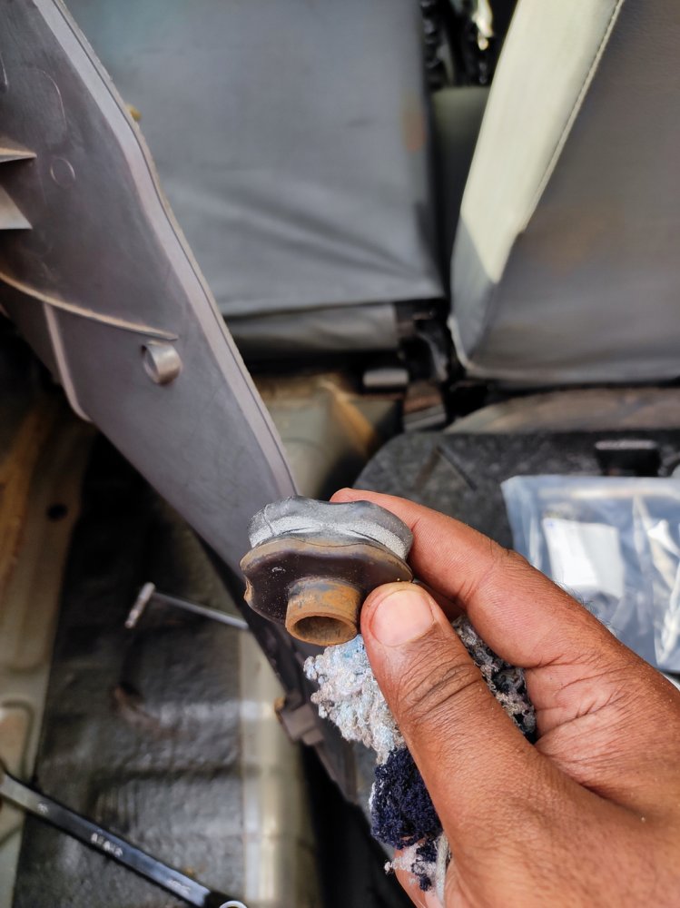

Remove one by one. First the rear shock absorber washer
and then the dust shield.
Exposed shock absorber. Disintegrate PU particle can be seen on the shock.
New vs remnants of old.
Squeeze the smaller side into the dust shield.
Washer. Clean it.

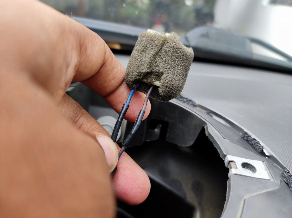

After popping the grille, all the dirty bits of damp mat used to prevent the suspected grille vibration.

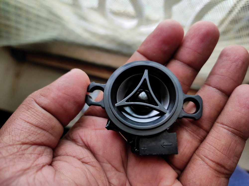

Another surprise package from Boodmo. A pair of Maruti Suzuki OE tweeters. Bought to throw away the Dapic craps.
Maruti Suzuki 39102M56RA0 - Came in Ertiga 2nd gen/XL-6 and 3rd gen Swift and Dzire. ₹ 205.00/piece with free shipping. Cheapest branded after-market tweeter was Hertz DT 24.3, retailing for ₹1900.00, but these OE ones can't match them and they came with proper high-pass crossover.

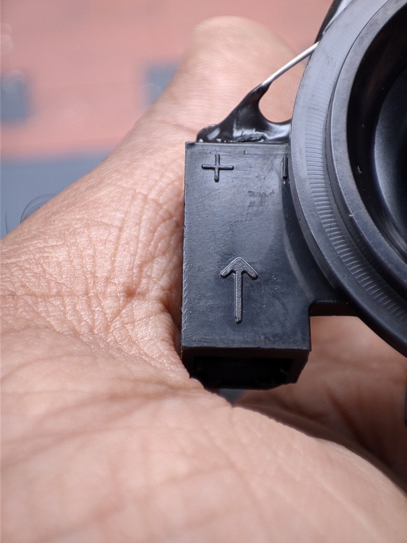

4 Ohm 25W. Comes with filter capacitor.

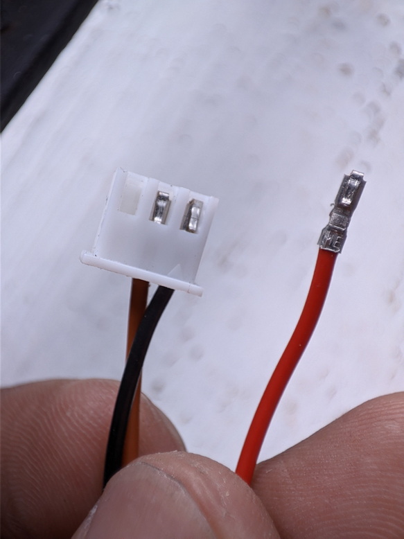

Three-pin JST connectors for connecting the tweeters.
Pop the screwdriver and pull the wire.
Scavenged connector. Right size for the tweeter pins.
Sleeved.
Polarity.
Connects well.

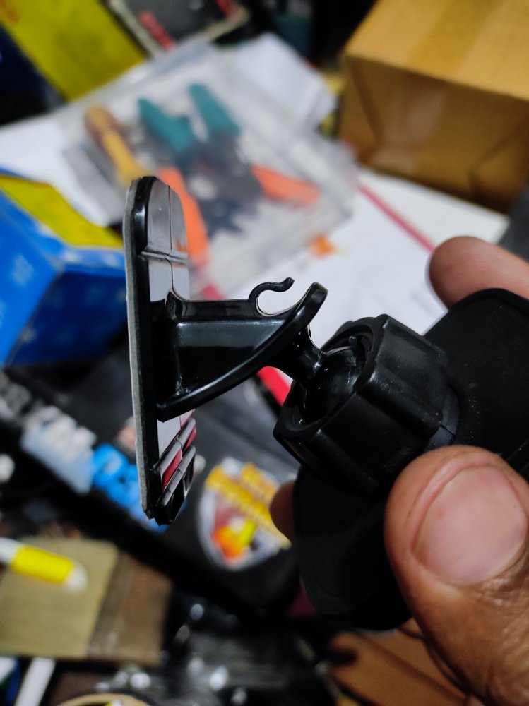

Saw this mobile holder at MGP when I was there for Estilo part hunt. Cheap, so bought it. Seems, it was in the display shelf for quite some time.
Magentic Mobile Holder - MGP 990J0M999L1-520 - ₹ 335.00

Had two plates to be stuck behind the phone. Just put them inside the phone cover.
Came with 3M tape.
Replaced with 3M tape [lol]
