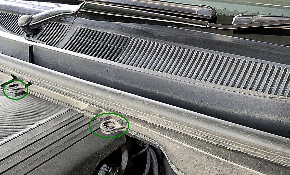

Step 1: Removing the locks for front passenger side cowl cover. After opening the bonnet, to access the vents for meshing, the passenger side cowl cover for the wiper assembly needs to be removed. There are 5 locks which in the absence of the special tool can be opened with a small flat tip screwdriver. The center part needs to be popped-up with the screwdriver and then the entire lock can be pulled.
Locks to be opened

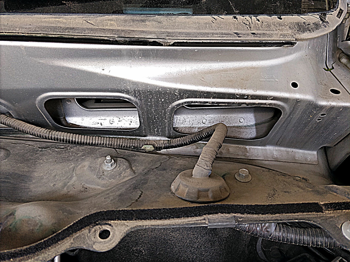

Step 3: Removing the cowling cover. From the fender side, the cover needs to be gently pulled upwards from near the edge of the windshield to open it up. The locks are along the windshield.
Passenger side cowl cover removed showing vents to be meshed
Step 4: Meshing the vents. There would be 3 rectangular cut outs visible behind which there would be 2 vents. The latter need to be meshed. The size of each of the vent opening is approx. 135mm x 80mm. The mesh needs to be a bit larger in size so that the edges can be bent. This would enable the mesh to fit on the collar of the vents. Double sided 3M tape was also used on the flat edges of the mesh to stick it to the vent panel.

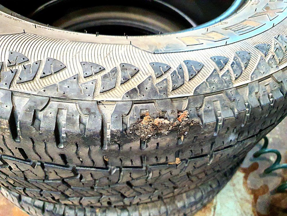

While this issue was already under observation, the punctures had really become a menace until a fateful night all hell break loose. While driving at 1 am, I could see on the TPMS that the Front Left tyre was loosing air. Found a repair shop at a petrol pump and despite repair, the leak started again after a few kms. Since the spare was smaller size (265/60R18), using it was out of question. Only solution was pumping air every 20-25 kms (by when the pressure dropped from 40Psi to 24 Psi) for the next 90 Kms of the journey. Later that day it was found that tread itself had developed a bulge which most likely indicated to failed / broken steel ropes internally.
Bulge in Tread at the outer edge
It was evident that this tyre would need to be changed but with the harrowing experience of not being able to use the spare, it was clear stock size was the best solution. Also in favor of the stock size was the overinflated look alike tread wear. Since the tyres in stock size were needed like yesterday, there were only a few options – Falken Wildpeak, Yokohama Geolander G015 and Pirelli Scorpion ATR. Selected the Pirelli since I had no previous experience with Falken and a fellow Endeavour owner was facing issues in his Geolander. Had used the Scorpion ATR for quite some kms on the Pajero Sport before selling it off on the same tyres. During their stint, never faced any issues with them.
Multiple plugs were used to stop the leak before finally making it to the Pirelli Center in Delhi

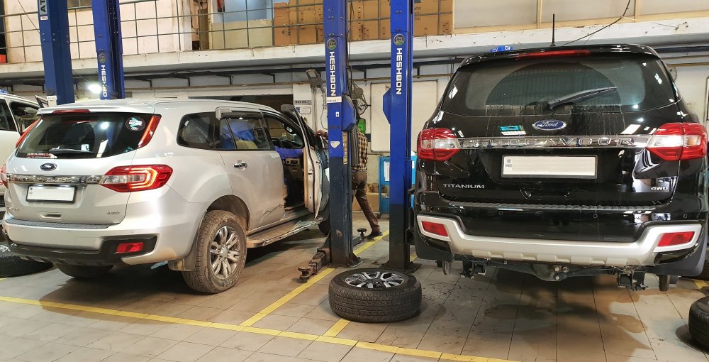

2 Endeavours getting serviced side-by-side
