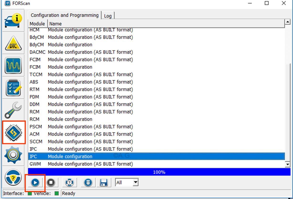

While preparing the steps to enable the Climate Menu in detail, I came across the post from the FORScan team that most of the changes which earlier required direct modification to Hexadecimal numbers in the As-Built files for the module have now been implemented in the latest update and require simply changing the option from a menu.
Disclaimer: Playing around with the modules of the vehicle itself is not a good idea. One wrong move and the module might be a thing of the past. Do it at your own risk as I do not take any responsibility whatsoever for any consequences the below steps may have.
The first step is to get a good quality ELM327 adapter preferably with USB interface having HS/MS CAN switch. In my case, I had modified the Bluetooth based ELM327 adapter which is working fine. The modification process for allowing the adapter to access the MS CAN bus is detailed in the link https://forscan.org/forum/viewtopic.php?t=4 and https://topscantool.com/modify-mscan-elm327-using-forscan.html
Once the adapter is modified to support both the HS/MS CAN, download the latest version of FORScan (https://forscan.org/download.html) and get the extended license by signing-up on the forum. The extended license is free for 2 months and can be renewed. After plugging the adapter in the OBD port, follow the steps below:
Step 1: Open FORScan and click on the About icon.
Step 2: Check that the Extended License is Loaded and is showing validity. Now click on Vehicle and interface information icon.
Step 3: With the Ignition in ON position, click on Connect to vehicle icon. Once the communication is established with ELM327, it will show a pop-up message with VIN or in my case as the profile was already available, it asked to continue with the selected profile. Click Yes.
Step 4: After scanning for modules on HSCAN, it will show a pop-up regarding MSCAN modules. As the ELM327 adapter has been modified to support the MSCAN switch, click Yes and it opens a new pop-up to set the switch to MSCAN position. Flip the switch on ELM327 and click OK.
Step 5: Click on the Configuration and Programming icon. From the list of modules, scroll and select IPC Module Configuration and then click the Run Service Procedure button.
Step 6: From the new tab which shows IPC Module configuration, double click on the Climate Menu. From the pop-up opened, select 1 – Enabled and click the tick mark button.
Step 7: Click Write. Carefully check and confirm the changes and click on the tick mark button. While programming, the Instrument Cluster will flash several times.
Step 8: Once programming completes and the information pop-up confirming Block(s) programmed successfully is received, turn OFF the ignition and then turn it back ON with-in a few seconds. You should now have the Climate menu on the left screen of the Instrument cluster. Now click on OK button on the pop-up and then Stop Service Procedure button to exit IPC Module configuration.
