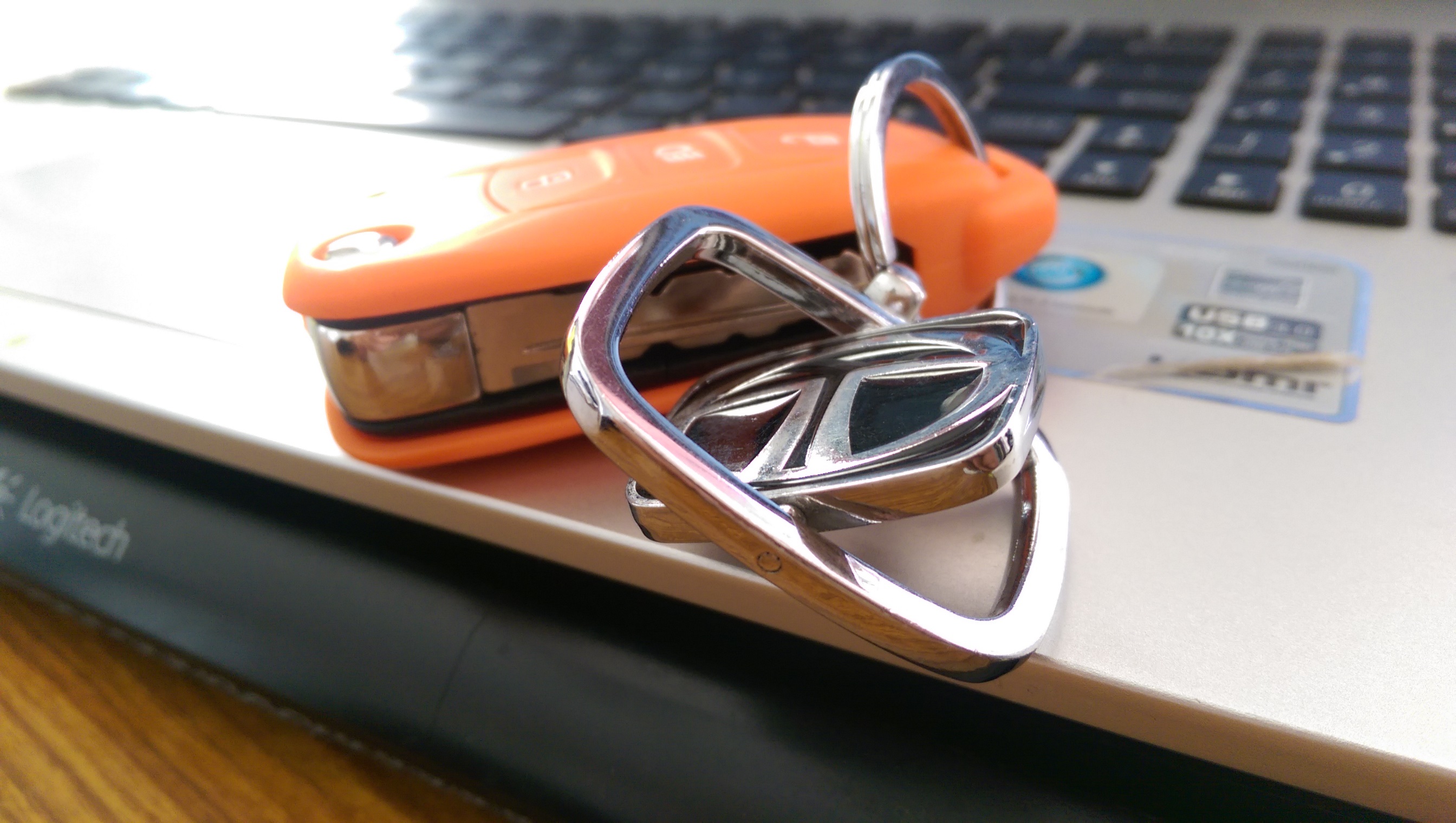

^^ Harley Davidson cover on Tiago key cracked me up!
How about Tata logo for Tiago's key chain [:)] ?
PS - Selvasingh Stores (cross cut road) has quite a few good key chains, most of them being Toyota, Hyundai & VW. Mine was was the last piece they had in Tata.

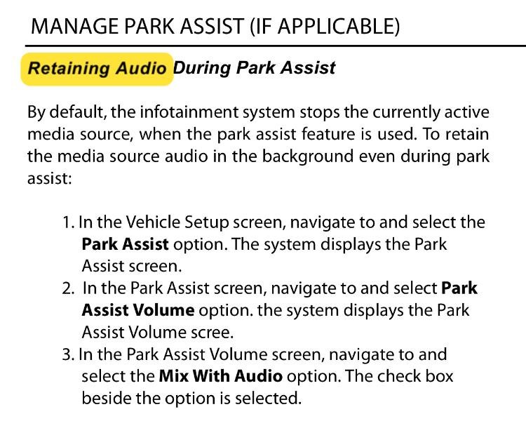

while taking reverse my music pauses and starts back when changed from reverse to normal..is that a feature or a bug?
This is not a bug and this feature can be enabled or disabled through settings. Below are the instructions from Tiago Infotainment manual.
SanthoshS answered this very well. I have set mine in 'Mix with audio' mode so that music still plays but with reduced volume.

i will check all the issues and firstly i m gonna enable sound mix in park assist
