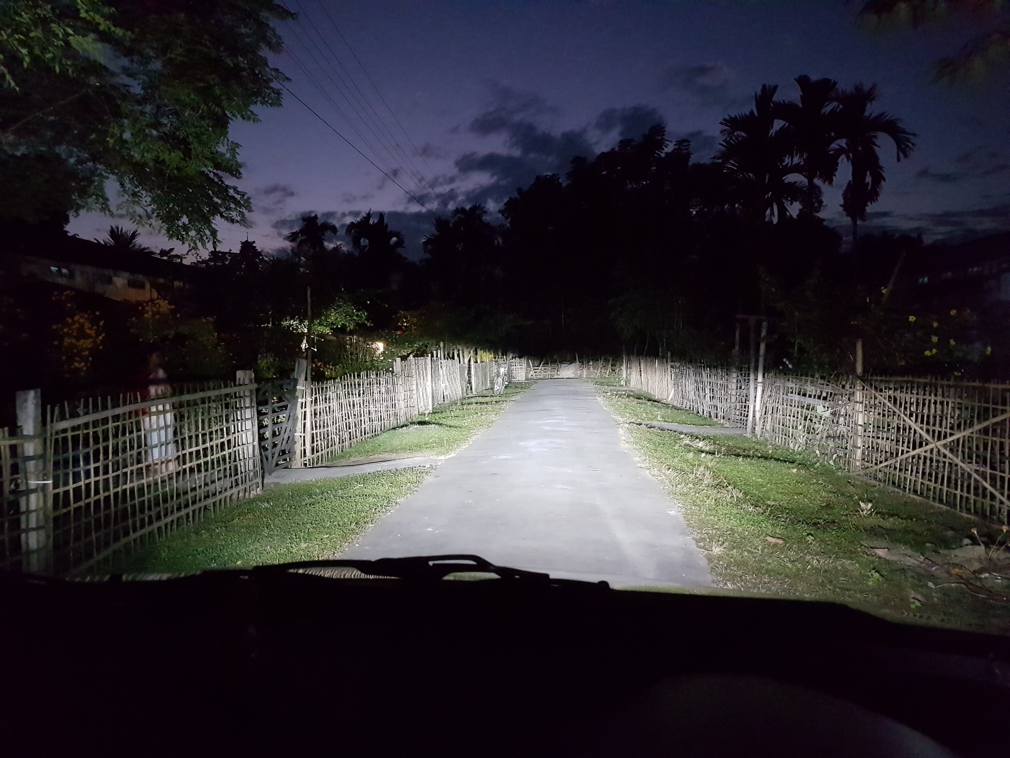

You can buy the LED Headlights that I have bought but sadly it is not available in Amazon. Aliexpress, Gearbest or Banggood are the place to buy, Aliexpress being the best among.
On Amazon, all you will come across are cheap Multisided COB Led Headlights but at a higher cost than it originally is.
As per as Fog lights are concerned, It is rather difficult to find 4300K warmer or Yellowish Fog lights so you better get Halogen Foglights

It took around 25 Days for the LEDs to arrive from Aliexpress to my address.
Color temperature is about 6500K but there is no bluish tint to the light output like in some cheaper LED Headlights.
As per as Rain and Fog is concerned, I have use it in a very slight drizzle and it was fine, same for Fog, have encountered very brief and rather thin fog recently. As per as I can make out, If the Headlight housing lens i.e the otherside of the Headlights is dirty, The light output from the LEDs gets scattered to some extent so keeping the outside of the Headlights is important.
And for LED Headlights being Legal or Illegal, well, we now have Cars with Factory fitted LED Headlights with Projectors like Suzuki Swift, Dzire and without Projectors like Honda City. Most important is to check out the Low Beam cutoff so that the light does not blind the on coming traffic.
As per as Retrofitting LEDs on Tata Tiago, you can snap a picture of rear side i.e the connection side of the Headlights and check for the clearance
