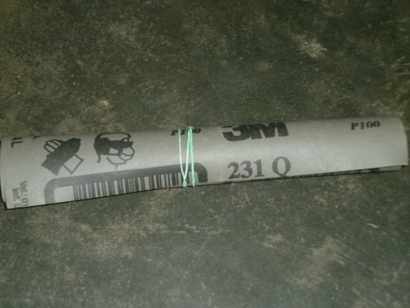

1. 100 no. sand paper Rs. 20 (for making the surface smooth)

First of all you will have to scrap all the rust using a wirebrush.
Then sand all the uneven surfaces caused due to rusting.
