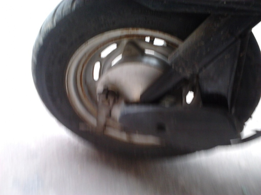

Here are a few pics of the moto-scooter

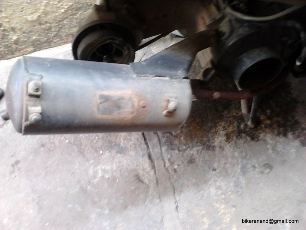

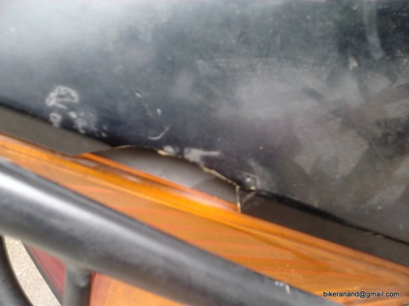

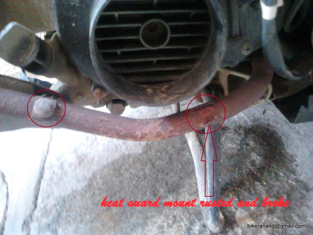

The end part of silencer in Dio does not get that hot when compared to bikes however the thin pipe area (that comes from the engine) is too hot and I dont have any special paint to apply. There are some imported cans available at J.C.Road which say "Heat Resistant" but I doubt if they would last.

Today I broke a small part of the plastic side panel (only the bolt fitting area) while I was trying to dismantle the complete rear part, will have to fix that as well. Also the exact opposite side was already broken (cracked may be long back).

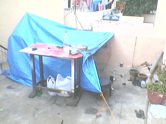

The rains played spoilsport and half my day was wasted, later I put up a temporary tent on the roof and worked on the inner plastic areas. However for the main body painting I need bright sunny daylight for sure.

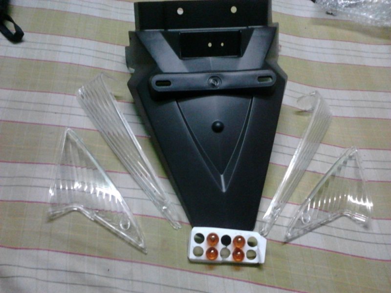

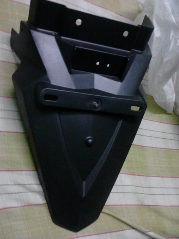

Yesterday itself I went to J.C.Road and purchased few new parts for the Dio. Here they are
New clear lens - Front & Rear indicator (glass only) - 65/- x 4Nos
Type2 Dio rear mud guard - 240/-
Orange bulbs - 4 nos - 48/-
24 size ring spanner for the rear wheel nut to be removed - 150/-

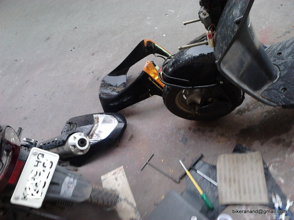

The rear most plastic parts of Dio is like a jigsaw puzzle, either you will crack it/ break it/ fingers damaged/ if lucky will open it without breaking after a long struggle.
Today also removed the speedometer frame and worked on that as well.

Please don't refix the broken panels if you do some tinkering on the mounting points they don't last longer.
I have seen at least three two four cases in my friend garage..
I am trying to work out a different solution for this problem and will update once its done. Thanks for the suggestion[:)], do continue to share your opinions and suggestions.

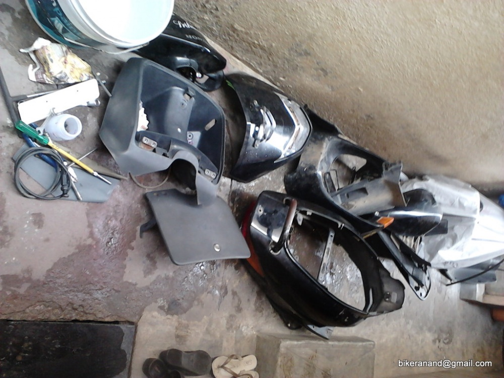

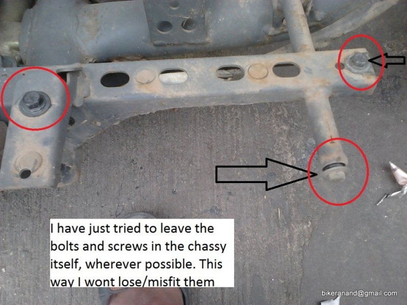

Today was another cloudy day with intermittent drizzles. I waited till afternoon and managed to paint the inner (rough plastics) plastic panels. After a long homework, I spoke to my painting guru and got a matte lacquer that should hold the paint on rough panels for a longer time. The lacquer costs a bit more than usual lacquer, I hope this works.
Also fixed back the front and bottom plastics (painted ones to the chassy) no space to keep them anywhere else. Also fixed the new type rear mudguard, swapped the reflector and number plate from old one to the new, just replaced the rusted screws.

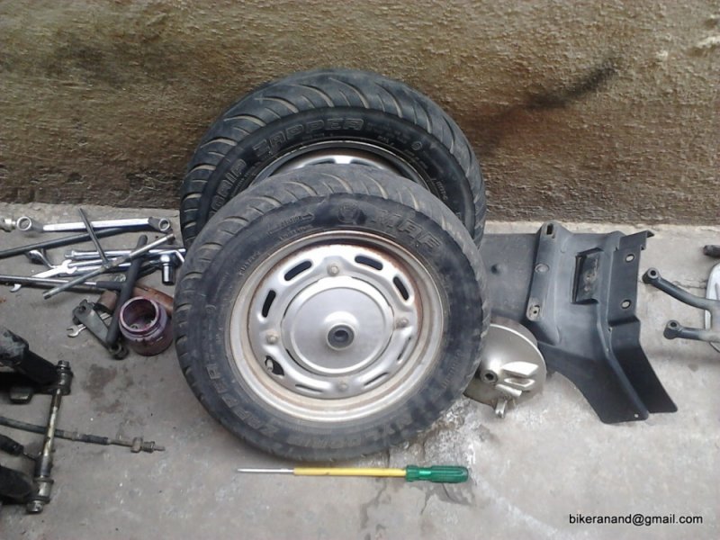

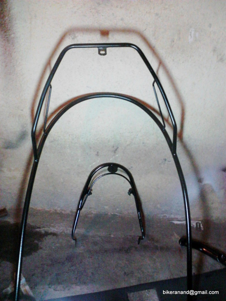

Today removed both the wheels, sanded and painted them along with the front fork, brake levers, body guard, lady's foot rest, silencer, silencer guard.

1. The silencer has two heat shields, one of them is very small and is held in place by 2 8size bolts, one of them was too rusted (on inner side) and the mounting point gave away. So now it will be on one mount instead of two.

I dont have much pics of the plastic parts painted today as I was doing it alone and this mobile camera really cant capture the good or bad finish of the black colour.

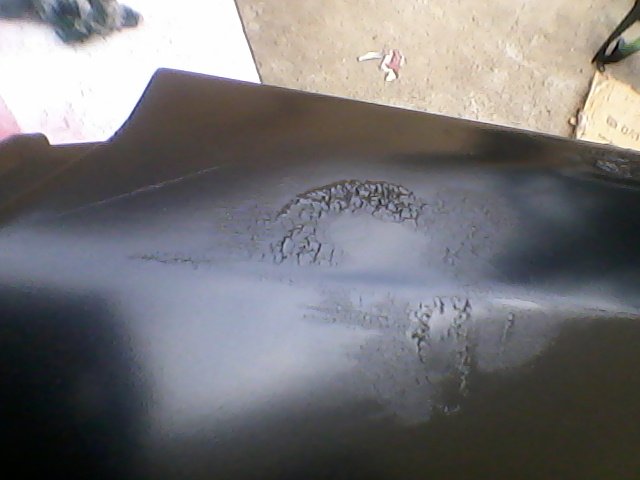

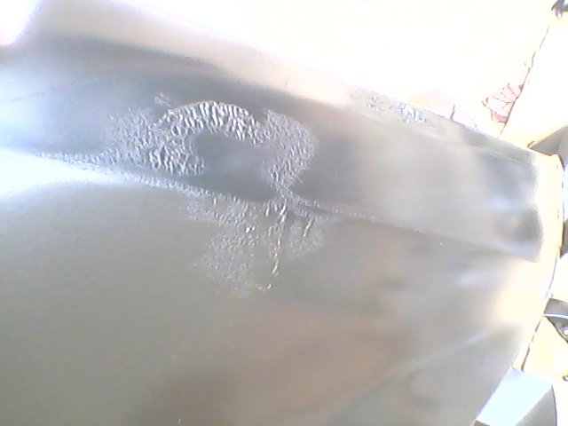

Took the wheels to the petrol bunk, filled air, came back home, cleaned break shoe outer areas and then fixed both the wheels. Done with all putty works and scrubbing also. Then brought the metallic paint and sprayed a few panels, tragedy struck here. One of the side panels started to show wrinkles and it continued to grow!
Here is a pic of the same.
then I rushed to the painting guru and he advised to wipe off everything on that panel and redo it. So started doing it, problem is the panel is too delicate, if you use thinner the plastic surface melts and kind of deep spots are formed, if you use putty blade, sharp scratches are left. So went back to him and he did it for me.

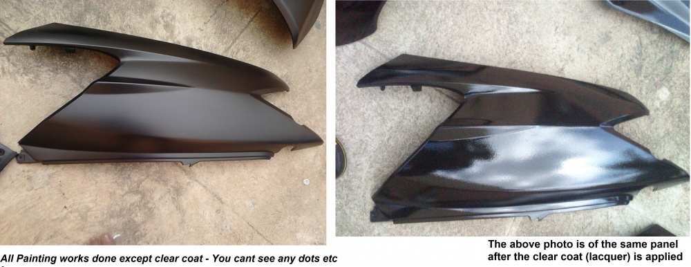

Yesterday I did a lot of corrections on most of the panels, including some more putty work, removal of paint in some areas and applied fresh coat of a petrol based base coat and the final metallic colour as well.
Waited till today morning and appplied lacquer to every panel. Purposely this time I kept the lacquer coat very rough and will have to wet sand it tomorrow morning. I tried to give an extra coat of lacquer to the handle part and the lacquer started to shrink. Not sure how it will look tomorrow morning.
A few pics:
Below is the picture of a complete fresh coat of paint without lacquer (left side) and right side is the rough lacquer coat applied on that panel after 24hrs.
Some more pics to come in next fifteen mins
