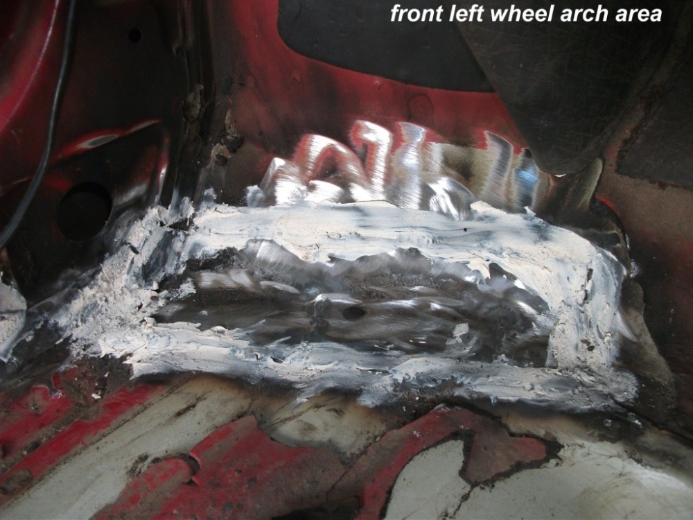

Just gave the car to the tinker now, he does a fantastic job, the challenge for him this time is a crack in the chassy, which needs a patch welding with a piece, running board damage & the 2 usual areas of rusting in most M800 & Zen's.
