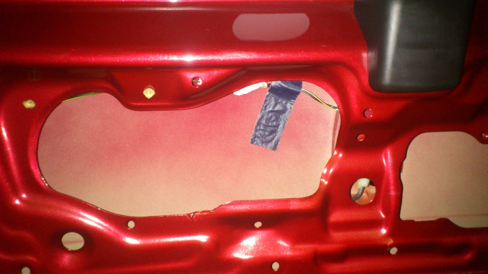

is this the motor mounting points which you have mentioned ?
can you mark the holes you used to mount the motor and a complete list of part numbers you have used ? i/m trying very hard to find the switch since it cost around 5000/= here in SL i was thinking when some friend of mine comes to India ask him to buy from there and bring here.[;)]
Same holes acting as mounting. drilled for only wiper motor rod and washer jet.
250 rs for the switch I will send you the part no asap
