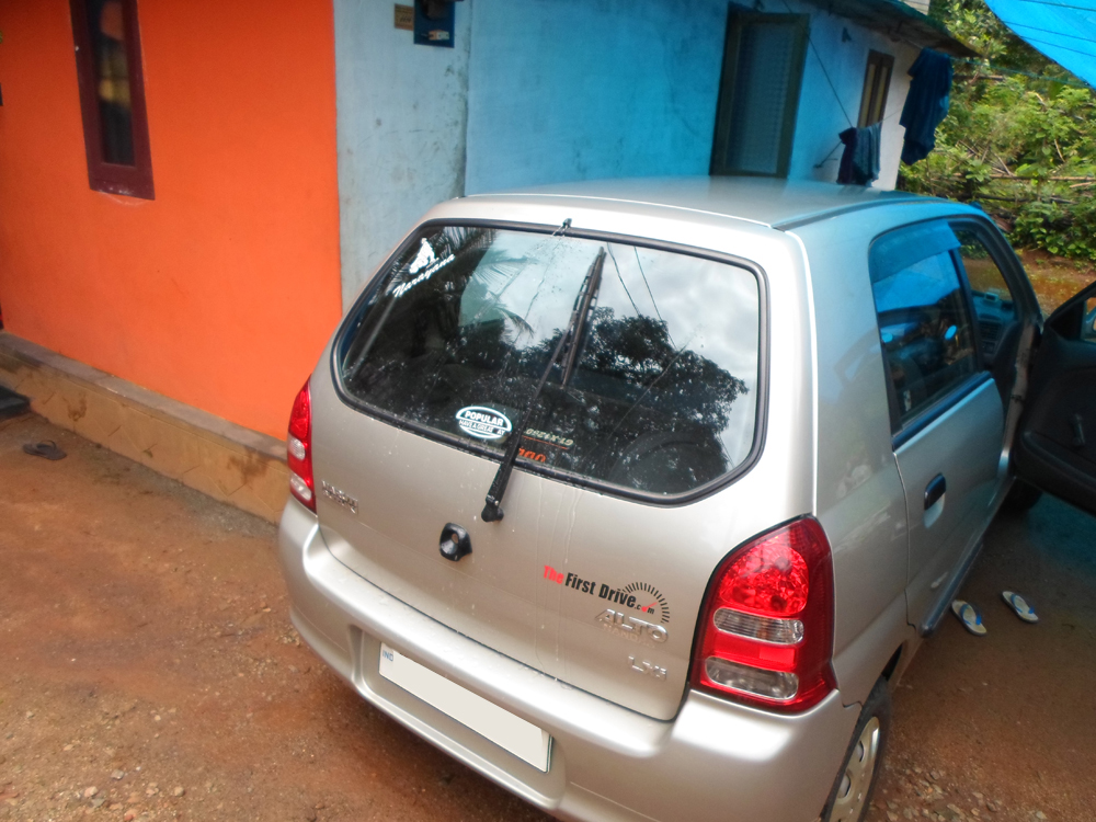

At last I managed to click some snaps of my car and rear wiper., I am sharing the pictures.
Let me start with car washing picture.
Waiting for my turn
Washing progress., look @the transparent Flashers :)
Fixed Switches on the dashboard
Wiper Motor
Wiper motor. Look at the green and blue wires. both are positives and the body acting as earth
Full cabin view
Motor close up
Wiring progress
Wiring progress
How it looks anyway?
Wiper and washer on action
Spraying entire area
Spraying area!
Altos front washer jet. Doing duty well.
Water all over
Wiping area
Washer jet
How is the perfection?

Cool, need more pic's of the wiper motor mounting.
Have you connected the wiper to ignition or direct to battery ?
Are those same plugs of a computer's SMPS which I mentioned ?
Thread Starter #25
Sep 14, 2011
937
285
Kochi
@Varun560061 connected to ignition not battery.
Wiper motor mounting I have to remove the rear pad again. Will do it. :)
Yes Yes it is the same pins you mentioned

GR8 Diy[clap] i wanted to do this to my alto for quite a long time and you have provided a nice diy for people like me to go ahead and get the job done
i have some questions for you if u can kindly provide some details with pics
1.with which equipment did u make 2 holes on the rear door?
2.where did you fit the water motor?
3.how did you route the wiper motor wires and the pipes that carry water to the rear door?
post some more pics of wires and pipes routing

Thread Starter #29
Sep 14, 2011
937
285
Kochi
Put holes using hand drill with 5/8 bits
Water motor fixed on the stock tank itself. I am changed the tank from the old VX to accommodate 2 motors.
wires and hose routed via door skill pads and the top!
