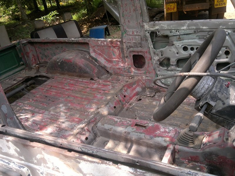

After sandblasting

The body condition is not looking as bad as in the pics posted earlier. To ne honest, i was pretty unsure of the health of the body, but now i feel it is much better than som ecars which i have personally seen being restored.
we are also worried about the body but after sandblasting the body looks good.
some places in body needs patchwork.
whole body is coated with epoxy primer.
the workshop guy said epoxy is better than normal oil primer.
patchwork will start from next week.
