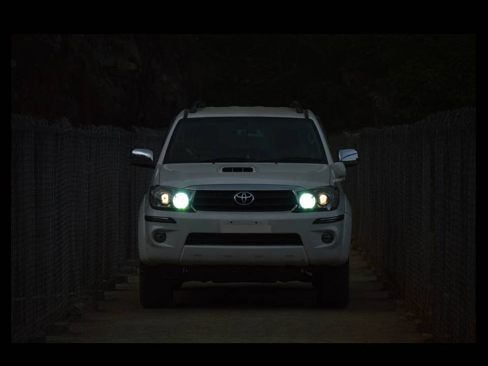

MAY DAY DIY:
I had the entire morning and noon free today and thought i will do a front grille black out for TANTOR. I had bought spray paint for my DIY painting of the M800 wiper .I had more than 3/4th can remaining and instead of preserving paint wanted to finish it with this cosmetic DIY.
Most of the description and pictures tell the story .Getting the grille out is the best way for a good finish and coverage!careful with the plastic tabs they can break if excess force is applied .
I took time to clean out the front of the radiator and the massive chrome of the Roots megasonic horns as the grille was out .Wash and sandpaper the surface of the ABS plastic so that the paint can adhere better .
Allow for 10-15 minutes between each coat for better finish and preventing runs.
This was my first experience with rattle can spray paint and was a good learning experience about the coverage and finishes achievable through variation of distance and speed of application .Watch on and give me your feedback friends
