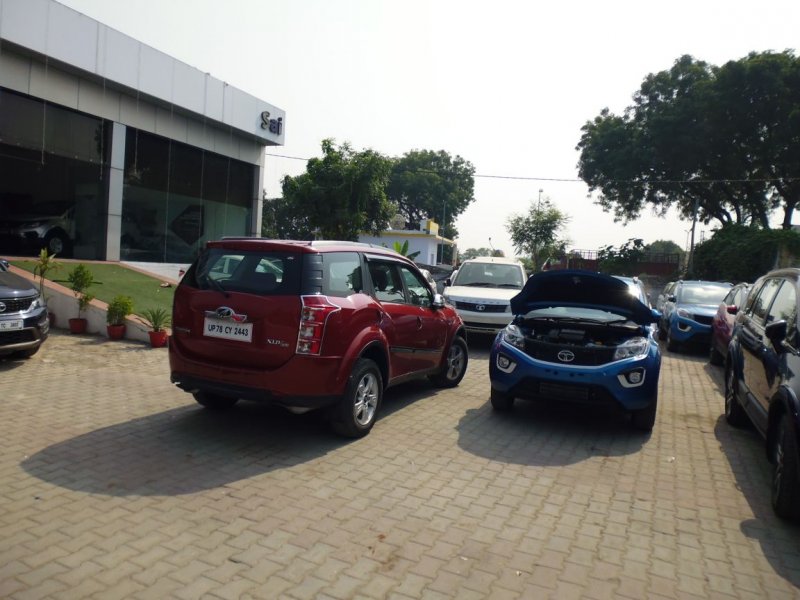

I need to get the A.C problem rectified soon.There is one more problem of wiper washer motor(not the wiper motor,its different).I went to retailer for a new one as it was malfunctioning.On installing the new one still no water jet!!Its either the fuse or a rat bite in the wires.Now I have to make a visit to the dealer,which I was avoiding for so long.Its 22 kms away ,one way.Sigh!
Well, I had to bite the bullet sometime,so I took out time to go to the dealer today.They opened up the fuse box,then the right front bumper.Then they opened up the nuts holding the coolant bottle.Below there they found the wiring for the wiper washer motor had been chewed off by rats. Damn!!It started the jets on joining them back.
Regarding A.C,there was only 112 gms of gas left.I got it filled up to specs,but if there is a leak still,it will go down to its old self non cooling state.Lets see..

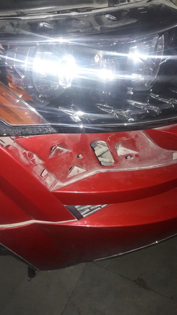

This time I was not satisfied with the service,because they went on a wild goose chase dismantling every part they can think of. It was very painful to see my bumper holes/attachments got broken because they pulled out the right side of the bumper outwards,to check the wiring.I oversaw all that took place.It took 4 long and tiring hours to get to the root fault!!There was no need to dismantle the whole goddamn ECU for it!!
At Least now the wiper works.I am happy to see that even the old as well as the new motor was alright.Now I have one spare working washer motor for the future.
Here are some pics from the recent service.

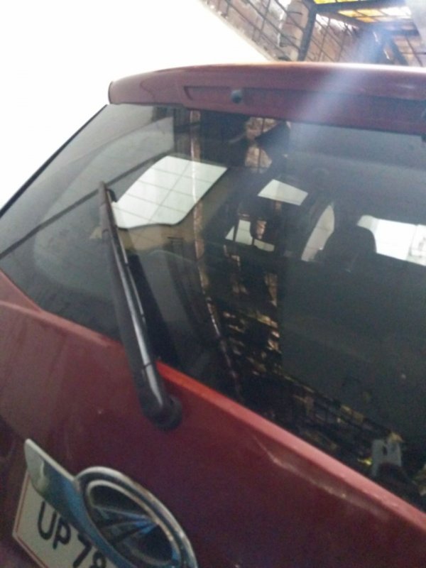

After 5 years of usage the rear wiper of XUV gave away.The rubber lining just came apart yesterday. I opened up the whole wiper assembly.The spring is so tight that if one is not careful,one might crack the rear windshield by suddenly snapping the wiper against it.But what pissed me off was the realisation,that mahindra does not sell the child parts of wiper assembly separately. This is done by maruti,and can easily be done by Mahindra.I was forced to purchase the whole wiper arm+spring as well the wiper cap,all of which were already with me in perfect working condition.I only needed the wiper length which has the rubber attached with it. It was costing 220 rs in the open market.Instead I paid twice that amount.
the bad wiper
after disassembly of the wiper
the old and hard rubber
wiper nut cap
new wiper assembly
new wiper assembly
old wiper assembly
new wiper installed
new wiper installed
that was all.Till next update.Thanks

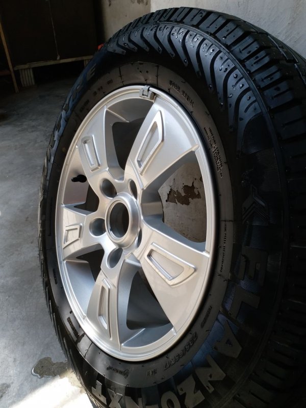

Decided to check the stepney tyre after many months.It was super dirty and covered with grime.Gave it a nice wash. It's all prim and proper now.
