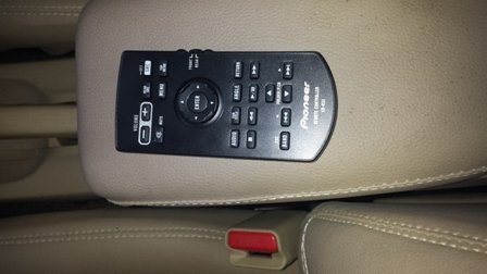

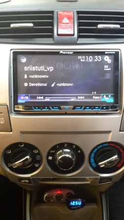

Hi Dr.Mudhan....got few installations...1) Reverse Camera, 2) Brake Lights [ordered for blinking one in aliexpress but got only simple brake lights to replace the reflector] and Yes 3) Pioneer AVH-X8690BT [:D]. my auto electrician advised me to not change any speakers as the OEM ones sound good. The only suggestion was addition of a sub with an amp. but my friend who is a service manager in Honda was against it saying amp drains the battery. uploading some snaps. video taken with my S4 is tilted by 90% to the left. wonder how to correct it? in VLC i can tilt correctly by menu options for viewing. members can pl tell me how to correct the video.
