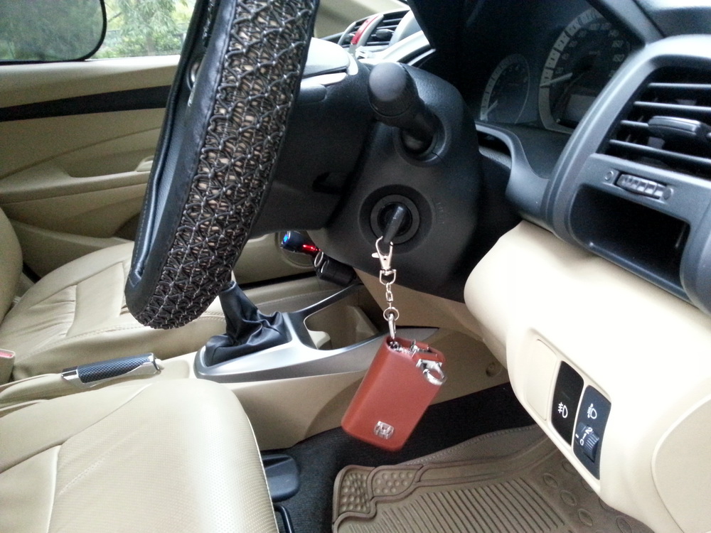

PART: LXVI
MY ALBUS: HOW DID I GET OUT THE "STUCK" IGNITION KEY!
Today morning, it’s happened.
I was casually turning the ignition key to understand the positions to affix the Ignition Ring Sticker which I recently bought.
Suddenly I realized that I could not get my car key out of ignition and though the car can start and go but when I stop, I could not remove the key. I checked up whether the steering lock occurred and that too not getting locked.
My mind started worrying … painful thoughts flew over immobilizer.. Opening the ignition cylinder and so on!
I left the car to check internet for help and it was still more confusing…
There were more help on “How to get into a car locked key inside” and more talks about hammering the key, airbag mishap, spraying WD40, some are specific to automatic gear cars etc.,
At last, decided to call Honda service and I was not ready for any costly mistake.
Suddenly my mind thought of my Automobile Engineer friend and I called and told him the issue. He was cool and gave me confident that it is not difficult to remove such key and it happens in modern steering design. He just told me to put the car neutral @ hand break on and to turn the steering wheel clock and anticlockwise and to give little pressure over the key to turn both side and assured me in one position the key will get released.
Ok I decided to try by praying the Almighty and did it – OMG it worked and relieved me from my mental stress.
Later, some good information I collected over this issue:​
HOW TO GET A STUCK KEY OUT OF A HONDA IGNITION
From Here: How to Get a Stuck Key Out of a Honda Ignition | eHow
Honda makes many models of sedans, coups and trucks for both private and commercial use. Honda steering wheels are designed to lock when the vehicle is turned off to prevent movement of the vehicle by anyone other than the owner. Occasionally, the steering wheel lock will cause the key to stick in the ignition, making it very difficult, if not impossible to remove. This is very common with many types of vehicles, and a simple method exists to remove the key quickly and easily.
Instructions
1 Ensure that the vehicle is off and in "Park" or "Neutral." If the vehicle is in gear or running, the key cannot be removed.
2 Place your left hand on the top of the steering wheel and place your right hand on the key.
3 Wiggle the steering wheel left and right, and attempt to turn the key into a different position, such as the "Accessory" or "On" position. Continue until the key moves freely.
4 Turn the key back to the "Off" position, then pull the key out of the ignition.
From Here: How to Fix an Ignition Key That Doesn't Turn: 7 Steps
Apply pressure to the key and turn the steering wheel back and forth to attempt to find a free spot where the key turns. A very common reason for the key not turning in modern cars is that the steering column lock can be in a bind. When this happens, you'll need to exert pressure against the ignition mechanism and persist until it unlocks. For those with a sense of humor, this is often called "the steering wheel jiggle."
[:D]
Dear Dr. Mudhan,
Greetings of the day.
Some problem occurs to me also 1 year before. i talked to my friend who is working in Honda. He said as this problem does not occurs in general. Reason behind this can be the car key ring. which i think so is quite heavy and put load on lock set. As now days we are have immobilizers in cars. May be it can be considered as one reason for key not coming out.
Thanks & Regards
