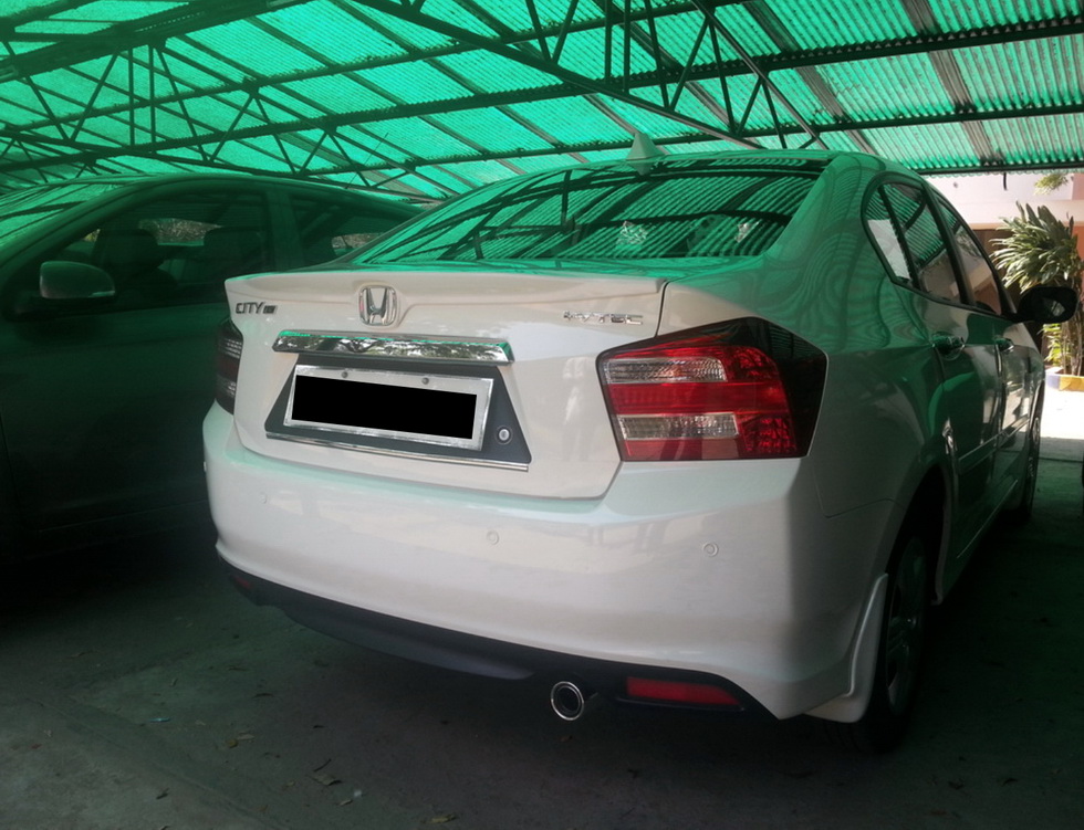

PART XXI:
MEET MY ALBUS WITH ‘DUCK TAIL SPOILER’
I got it. Of course, it needed continuous follow up with Concept Cars, Calicut, Kerala.
(Please refer first my earlier write up: SOMETHING ABOUT 'THE SPOILERS’ @ Page-9)
Finally I got the painted one, taffeta white from them through courier, and the total amount paid is Rs.3160/-
Quality - Material, yes really ABS one & that is excellent, painting is also excellent.
Packing – original packing- but I felt that they should have stuffed with waste paper as there was a gap inside the box but spoiler was packed well, so no scratches happened.
There is a provision as in the original Honda spoiler for drilling and fixing, bolt screws were provided; but no double side tape or holes for fixing the Honda logo were there.
PROCEDURE ADOPTED:
First I removed the original H logo by pulling off the small plastic knob holders inside the dickey lid using cutting pliers. Cleaned and polished the logo, and carefully cut off the projected pins, pasted 3M sticker all around hiding back and by not making it visible outside and fixed on the spoiler, after cleaning the surface with spirit.
Now the spoiler- cleaned the inner side with spirit & pasted 3M, specifically covering the center, periphery and closing the screw bolt holes inside. Avoided 3M visibility externally. I found out that 3M tape requires some setting in time for firm bonding and therefore I left it overnight at home.
Next day morning I took the spoiler, kept on the dickey, marked the line by red color crayon. Cleaned the surface over the dickey within the margin with alcohol & old logo area as well.
Now it was easy to remove the tape’s red paper with the help of the paper cutter tip and, brought to dickey, carefully fixed it, after holding with pressure for 1minute.
Cleaned the crayon mark by using Amway silicone glaze. Wiped the spoiler by MF cloth.
My Albus become unique again :wink:.
