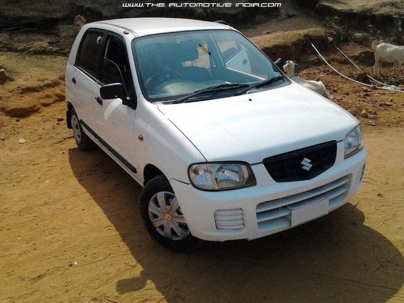

car is looking nice.
Wow! Looks nice. Just get new type ORVMs of K10 from some aftermarket shop.
The car looks incomplete without that. I am also going to get them.
