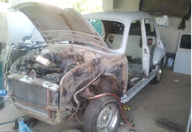

No ClassiCar, The same body... Me and my tinker worked throughout the body lines (both inside and out).. Water draining in the water channel is an important work which i mentioned.
So you cant plan the work and time estimate when you work on Amby completely.Since there are many areas which we cant see physically without removing the front parts.
Importantly the Tinker who working on our car need to be very interested in his work.Otherwise its very difficult to work around to our perfection.
The gear box sheild which was done took 4 to 5 days. The Powersteering column has been adjusted and the work perfection will only satisfy fully when it fitted with other related things.

Mechanical realted work :
Oil Service,
Radiator cleaning and need to change the Hose type of intake water.
May be Four wheel brake cylinder checks.
Painter will handover the vehicle to Mechanic before the final coat.

Update of first 15 days in 2013 :
1.Oil Service done and cranked the engine.
Took the car for Dashboard and console fittings.The work is going on very smooth and the skelton of the dashboard looks nice and havent got a clear picture of Console setup.
I need it to be bit different from other consoles.But God only knows how the outcome will be.Let me update the images, so that there will be a clear picture of that.
After the fittings the final coat painting work will start.
