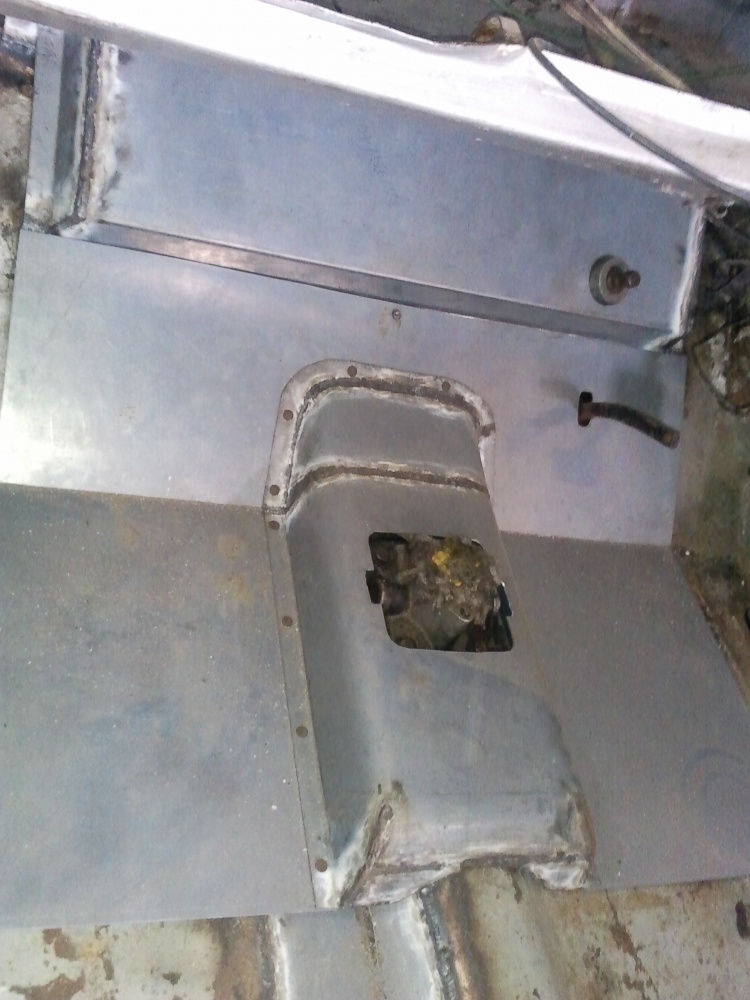

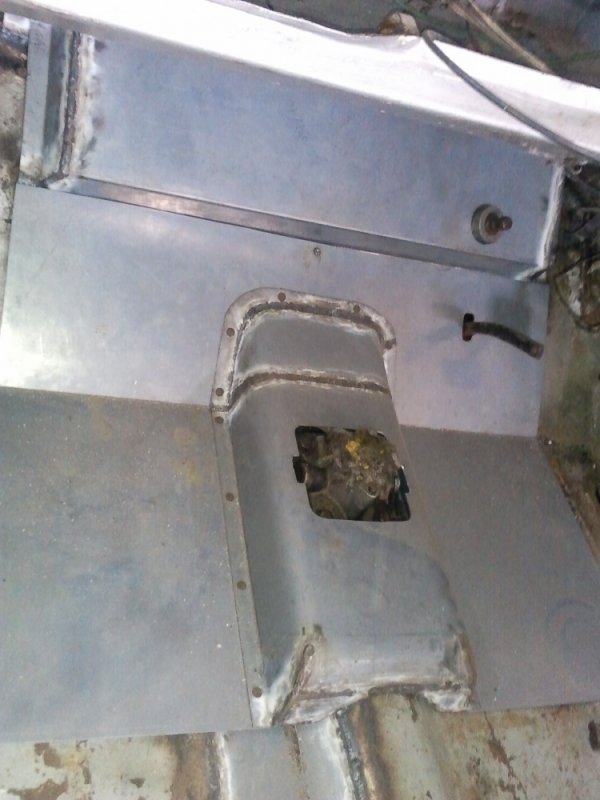

I have been out of action for some time..My Amby is in Workshop for almost 14 months..The guys working very very slowly.. But the work done was good.
I planned for tinkering and Painting.Also change of interiors almost.Now i need to check the budget also.[surprise]
Tinkering is done and waiting in the painting shop to get a good coat of White Dupont.
The flooring was not fully changed.
Runnning boards changed.
Wiper channel Changed.
Water channel done some work on it.
Dick area modified to new version with some customizations.
Gear box top has been changed to fit properly in the floor.
Bonnet and Dick gap modified.
Dick open like in latest cars
Customised dashboard - not interested in new Dashboards.
Pending :
Electricals check.
Koyas interiors.
AC fittings.
Here are some pictures of the current status.

The last images were the mudguard based work.Even a small hole is patched.The water channel was neatly done at the bottom peace which comes near the Mudguard top.
It may look like a very small work, but it took several days.Dick peace of my vehicle is done by the tinker based on my input.It is not the ready made peace.
