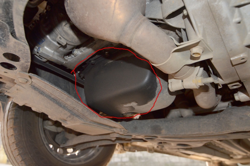

I am surprised to see this kind of oil leak on a car that came out of Maruti! Is it because the Oil Sump gasket is gone bad? but isnt it too early for such complaints?

Dear friends,
I too seen oil leak near sump. Is that same place where you found oil leak in your Ertiga?
Bro, I see scratches on the aluminium body near the crank case,
if you claim for the leakage i do not think they will take the responsibility with that scratches, they will claim that the leak is due to the under body hit which produced that scratches.
Is there any more scratches near the crank case?
This leak i think is due to the gasket and can be replaced easily.
Apr 4, 2012
2,524
250
Aluminium parts have scratches like that sometimes.I have seen alternator bodies with scratches like that.
One of the members had the leak even after the sump gasket was changed.The crankcase seal was the reason there.
