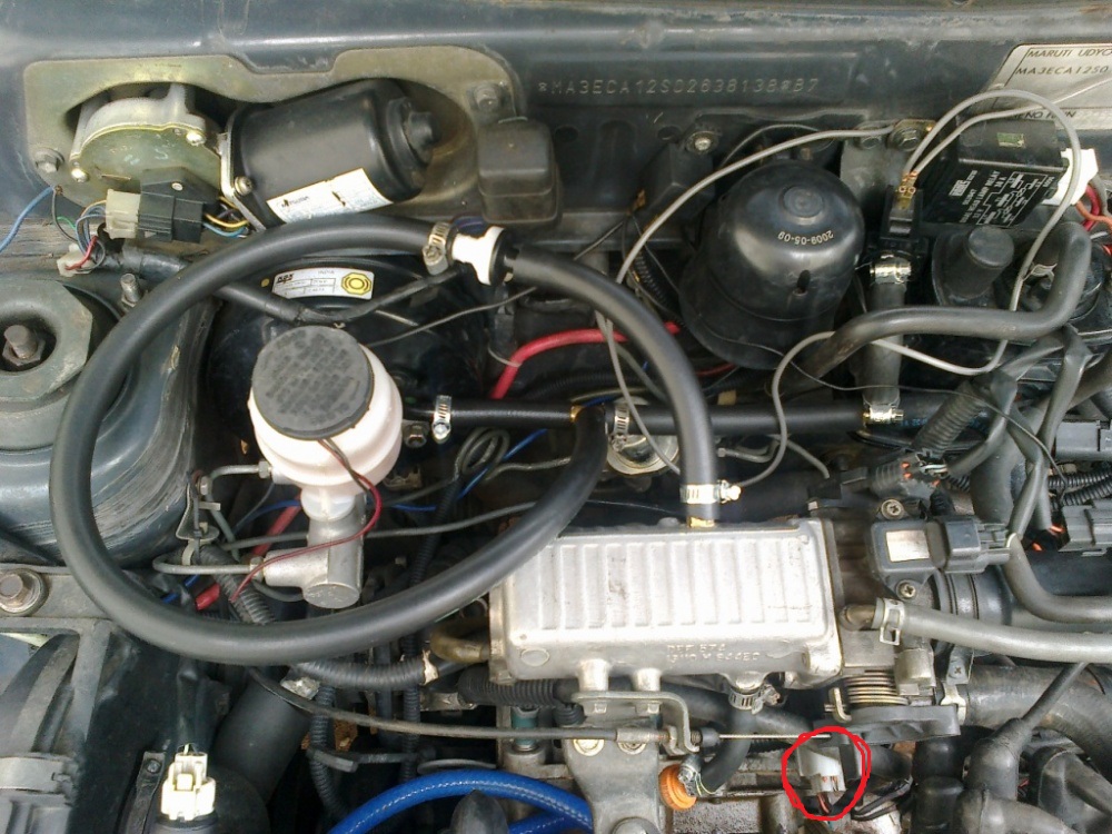

Dear friends.. In the attached photo I rounded one plug in Red color (image is downloaded in net not my car image). This plug broke in my car. There are three wires colored Red,Green, Black are separated. I need to connect them without plug temporarily. I am confusing which color wire to connect BOTTOM PIN and which color wire to MIDDLE PIN and which is to TOP PIN. Can any one please explain me clearly. Thank you.
