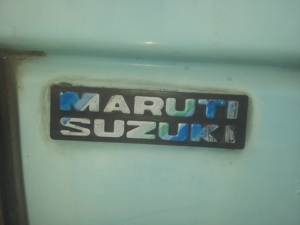

Raj007:The logo seems to be like that due to being covered/masked during painting.If you still feel it is something else, you need to google.
