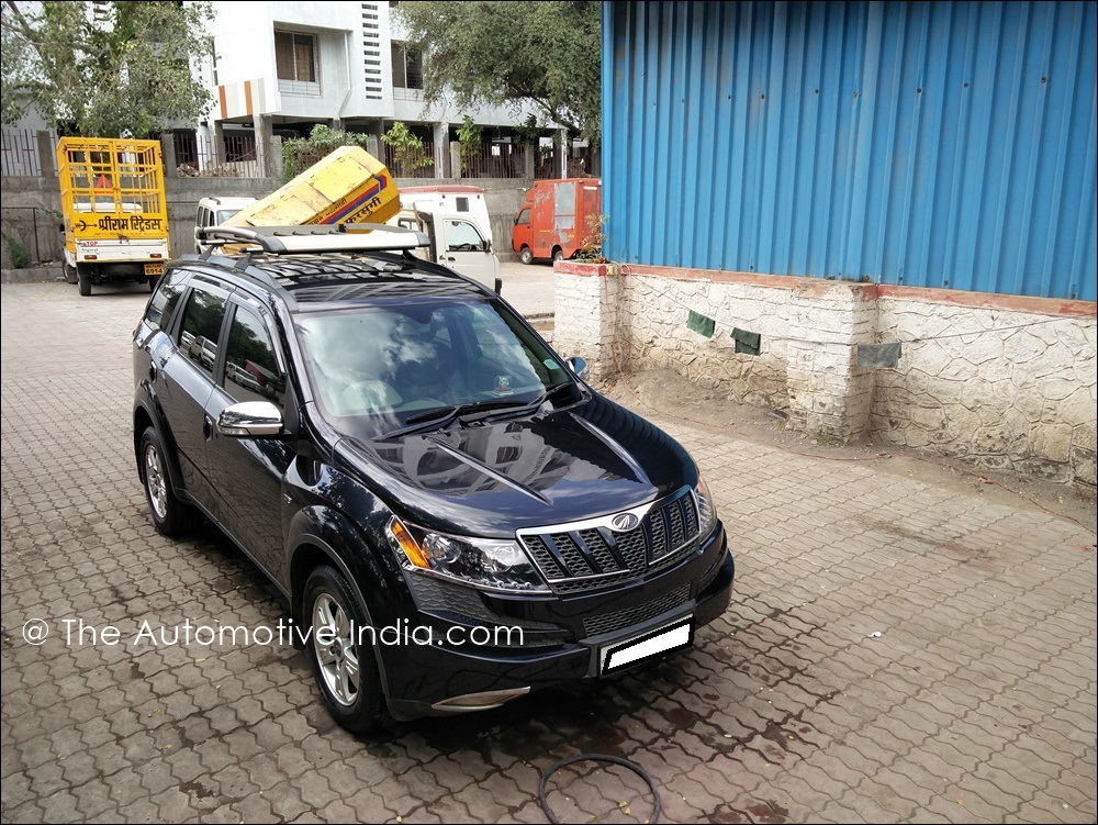

The paint finish looks amazing IR.
Hard labour with the meguair wax 5 months back, however this pic was just taken after a svc steam wash, the last wax was done over 5 months back but the wax effect has been decent. I am in the process of moving to Collinite, i really like it and its very hardy. Service centers in pune (especially the big ones) are moving to steam wash now to conserve water (municipal directive as well) - to be honest the picture came out a tad too well.
Ill post a pic once i do the collinite job, hopefully next week. The Xuv paint state is err not bad for a 4+ year old vehicle now.[:D]
