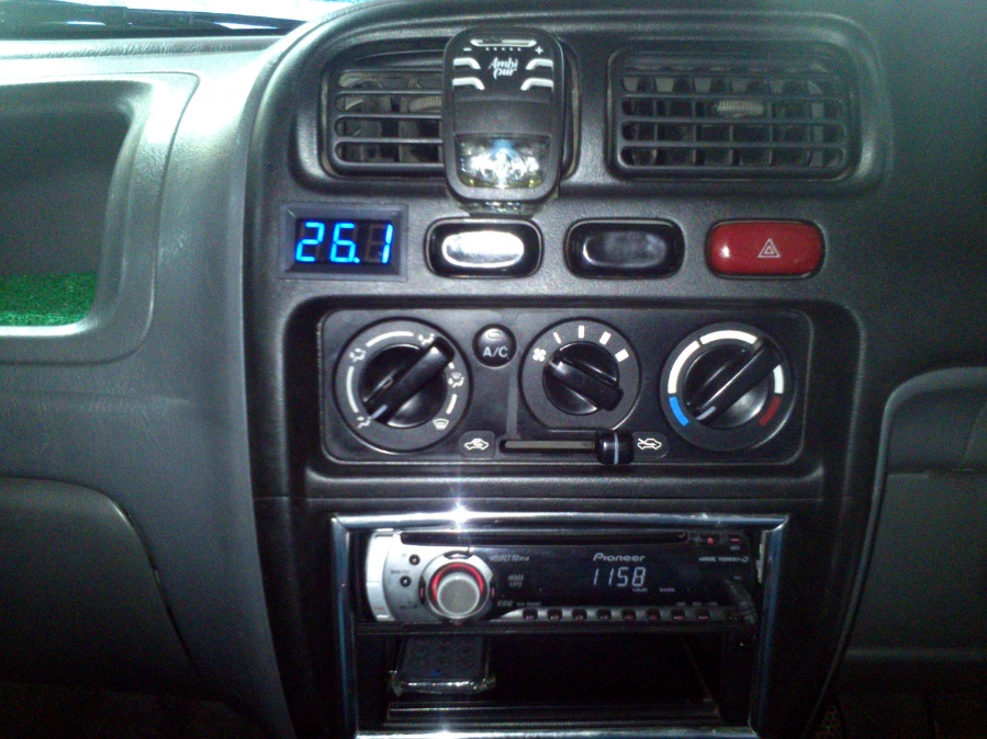

There was a drill bit to make hole for camera on bumper. Used that and installed camera. Then video cable installed from boot to A pillar. Camera cables connected to reverse lights. Camera installation done and now came difficult part. Didn't want to place the monitor on dashboard sticking with 3M tape. Because it will be only for reverse camera and i am not going to use it to watch movies etc, when i will use GPS on my Galaxy Tab two screens will look odd and difficult to clean dashboard, wires will be visible and will look bad, monitor have to face direct heat of sun, can invite thieves. Decided to fix it in sunshade. It will not be visible when will not in use and when car will be parked.
Rest of the story is in pictures»
![IMG_20141014_083901.jpg](/forums/data/attachments/135/135503-02a4a481270b23a5fa8cb59b311dfcde.jpg)
