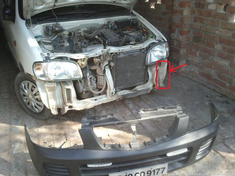

For the front bumper removal/installation, I need to do it for few reasons as follows:-
(1) While trying to fix loose headlight nut by the mechanic, the "STAY, FR BUMPER RH" (part number) nut has broken and is stuck into the washer. Please see the attached screenshot (One.jpg) marked with Red arrow. I have purchased this part for Rs.90. Ols guide how to change this.
(2) Some sound appears while driving. Suspect some bolt of the heat insulator panel is missing which need to be fixed due to which it is vibrating and causing the noise.
(3) I need to level the headlight (Lumax model with inbuilt motor) beam whose screw behind seems to be jammed and is not rotating. So would remove the bumper and try to rotate the screw to level the headlight beam.
Please guide with (pictorial steps if possible) how remove and then install back the front bumper.

1. If you have purchased the part, remove the old pard with dill ,if it has stuck inside.
2. Post a picture of that insulator , if you can see the bolts of screws are missing , then refix them.
3. Don't remember if it is necessary to remove the bumper to remove the headlight or not.
If you want to remove the bumper you can do it easily , all you need is a star screwdriver and a 11 number spanner . Location of screws and bolts are , inside the fenders upper portion , bottom of the bumpers , behind the license plate, under the hood upper portion of bumpers. There are some plastic push locks also.

Yup, referred to our Alto's pic. Just a minor correction in your reply. The bolts are 10mm in size, so u got to use a 10 number spanner or wrench. The bolt behind the number plate is deep inside, so the spanner is not easily reachable to it. I have ordered a T Spanner with long handle for this
Also for the headlight, there is one bolt on the top which can be removed easily. But for the other bolt, it's at the lower end covered by the bumper, so the bumper needs to be removed at least from the side of the fender.
Just fearing if I remove the bumper, then I can put it back or not [lol]
Attached is a pic of the heat insulator panel.

Yup, referred to ur Alto's pic. Just a minor correction in your reply. The bolts are 10mm in size, so u got to use a 10 number spanner or wrench. The bolt behind the number plate is deep inside, so the spanner is not easily rechable to it. I have ordered a T Spanner with long handle for this
Also for the headlight, there is one bolt on the top whcih can be removed easily. But for the other bolt, it's at the lower end covered by the bumper, so the bumper needs to be removed at least from the side of the fender.
Oh thanks for that correction . Isn't that screw type bolt there behind number plate? If not then you have to purchase that T spanner . If you are thinking more DIYs in future then instead of single piece ,you can purchase a decent kit of T spanner with different sizes heads.
Yeah i remembered there is a bolt right below the headlight on outer side. You can remove it with ling screwdriver after removing two screws of bumper of same side ,it will creat a gap between headlight and bumper. But it is difficult . If your want to fix that panel also then its better to remove the whole bumper. Its not difficult if you have propper tools. I didn't remember how many times i removed and fixed the bumper of my alto.

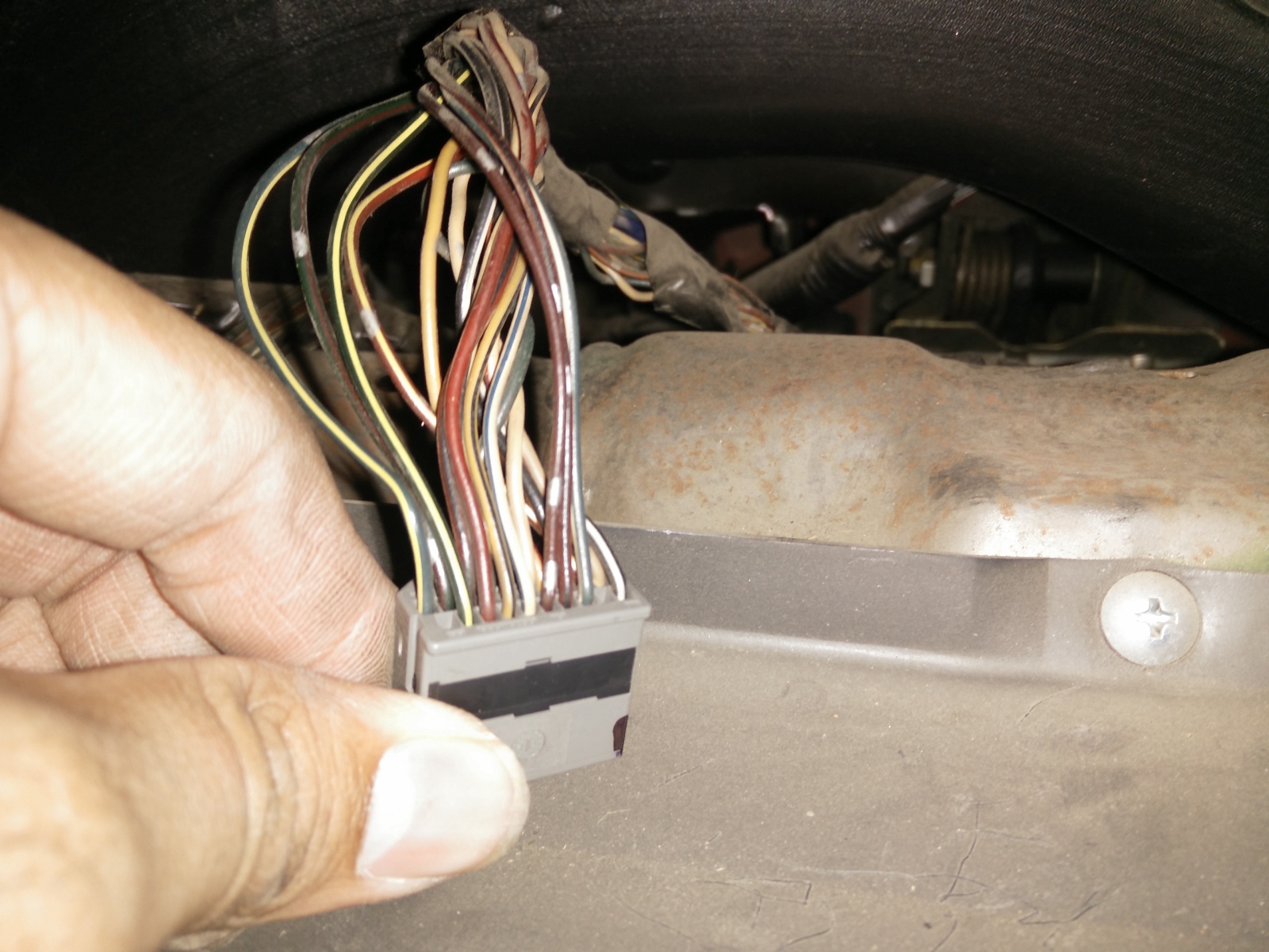

Hello guys, I am trying to install after market tachometer on a 2010 Alto LXi.
Can the experienced here tell me which of these wires is the RPM signal?
Hai why you want take it from Speedo console instead of taking it directly from the Power steering module buddy!!!!!!!!!!!!!
Manufacture may not give the wiring in some cases due to cost cutting factors????
