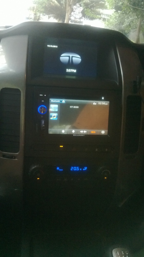

Friends finally the ICE setup completed.
Products used.
1. Blaupunkt LE500BT head unit.
2. JBL GTO 504EZ amp.
3. Polk audio MM691 6x9 inch coaxial.
4. Hand made MDF faceia.
5. Focal 10 inch enclosed sub.
6. Enclosures for the mm691 speakers.
7. Some leftover speaker wires from my home theater project.
Since the harness for my aria pride is not available. I ran separate power wires from the amp. To the HU.
Since The OEM speakers in my car is sounding great, I dint want to change them.
I have placed the mm691 in the boot so that the sound is filled every ware.

Dude you have Discotheque on Wheels! Also now the center panel of Aria now looks like a premium car. I always had issues with the panel not looking jazzy. I think TML should take some ques from your design. Need to have high res images of the panel.

Wow that looks like command centre of a space craft, its looks neat. is it visible though from the second row ?
Yes it is.however the top OEM screen is eye catching.
