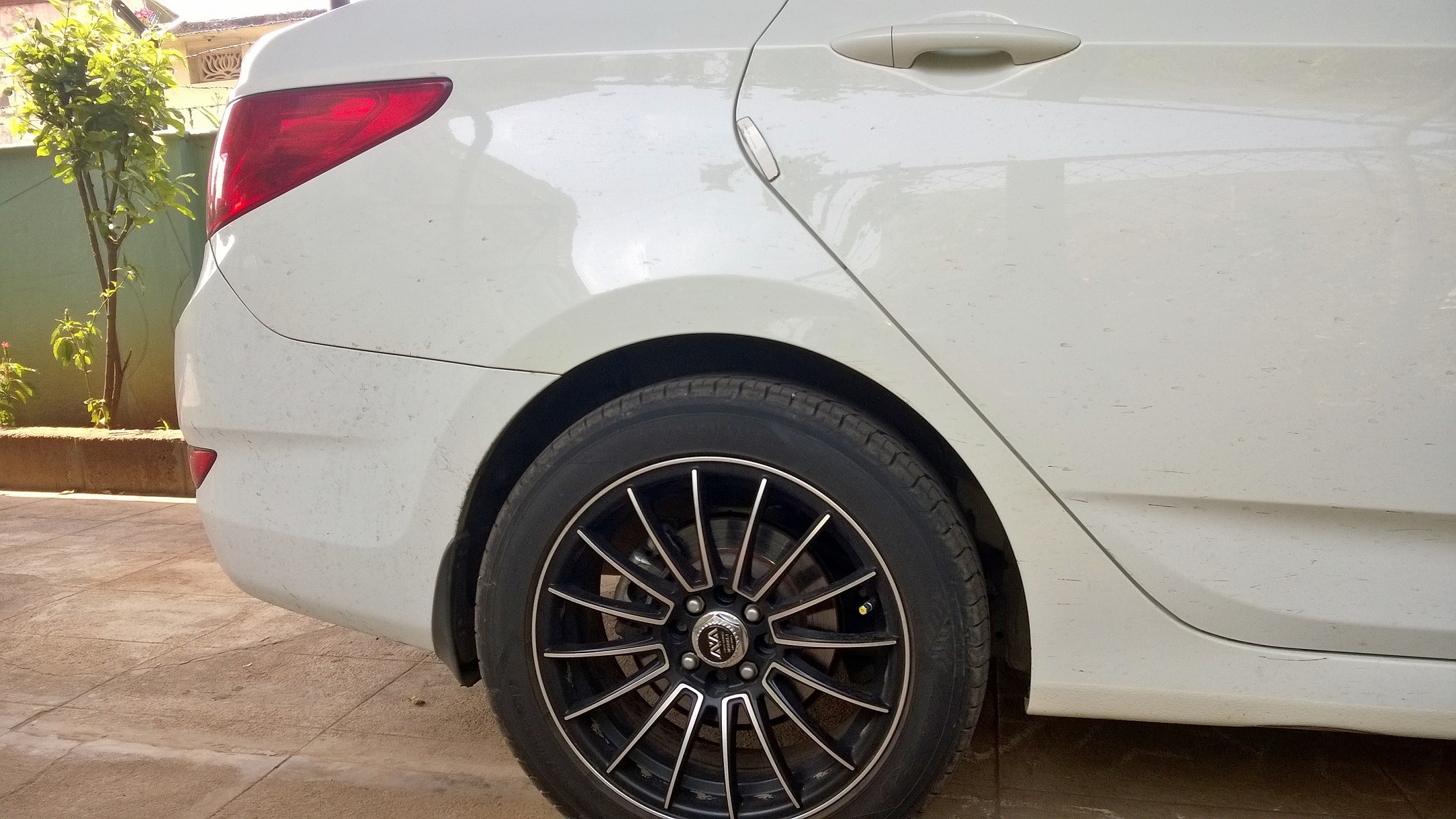

May 25, 2014
9
chitradurga
hey guys i have put 16"alloys with 205/55 R1 yokohama tires recently for my car fluidic verna.The problem is rare body is touching the tires when 5 people are seated in uneven roads that is scary.Please any body help me with this and find me a solution?
Thread Starter #27
Aug 27, 2011
613
37
Did you put spacers??
Can you post the current pic of the car so i can see how much space is left between tires and body.
Your solution is on this page itself. Get buffers.
Btw i liked this alloys.
Thread Starter #29
Aug 27, 2011
613
37
It is the only solution until you want to spend 1 lakh for aftermarket suspension.
Tires are not touching body with 5 ppl in car now.
Get it before you damages your tires. At least as a temporary solution or i can see those marks in pic that you already started damaging tires.
Your alloy is 16 inch and they are usually 7j which is wider. Mine is 15 inch 6.5j and same tire profile as yours still it was touching at the outer edge of tires.
Get b4 size in buffers. It will fit.
