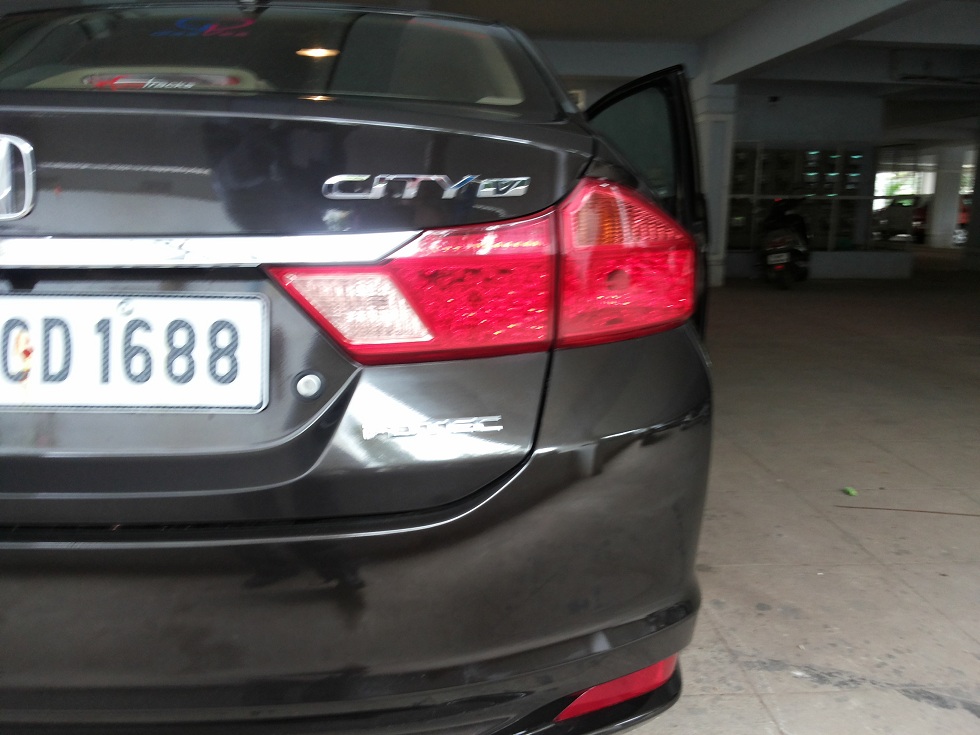

Was anything scraping on your rear tire?
I mean, the car us looking quite driveable in the pics with nothing touching against the rear tire which can obstruct its movement. If there was nothing wrong then why you called roadside assistance?

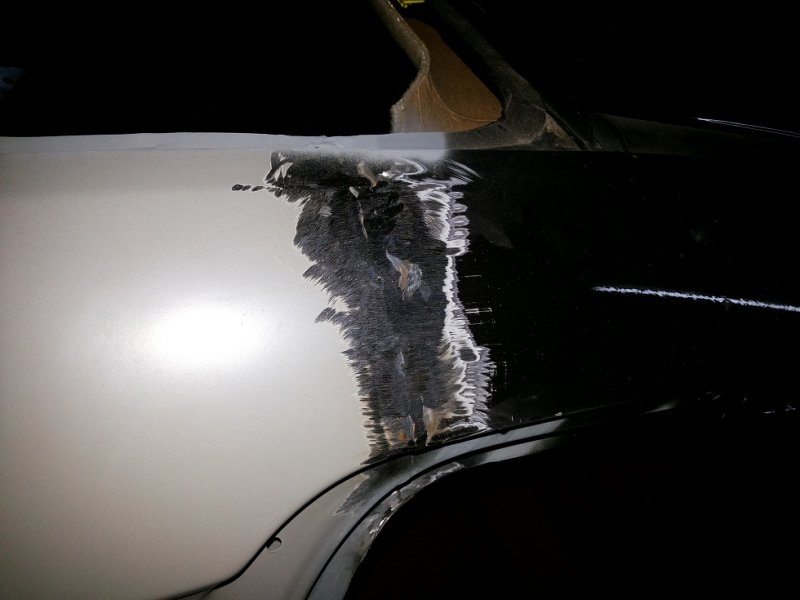

Vipul, the bend portion of the quarter panel was scraping my rear tyre. I tried enough to bend but still it was scrapping. I tried to move with the scrapping, but I could not tolerate the crying sound of my Ashtra. (Felt it like asking the person to walk who has broken leg). So I called the RSA.

In your case, the damages are deeper as I can see and hence take care that they do the denting work such a way that your rear quarter panel and your tail light to fit perfectly(even if you have to pay some chai-paani to the SA, no issues, the car needs to be back to perfect shape).
Since the denting work actually makes the locks and their locking points go a bit out of sync or say out of place by a mm or two and hence the perfect fitting of bumper, tail light, panel etc is tricky, but if the denting guys do work very carefully, then quite good finishing can be attained. So ask the SA to take care that nothing goes wrong with the finishing.
After the work is completed, please do check the following things thoroughly:
  • Denting work and fitment of parts - especially the bumper and tail light
  • Open the boot to check if the paint is removed from any point on the inner surfaces
  • Check inside the rear wheel arch for any signs of improper fitting and in case you find the plastic covering inside the arch loosened or improperly fitting then get it changed - this part causes problem in later stages by coming out.
  • Close the boot, take a jug of water and drop the water slowly throughout the gap between boot and the car body starting from the rear windshield. After half hour open and boot and check if their is any water seepage inside - if yes, then get it rectified.
Actually during the denting work, the workers frequently mishandle some parts and getting something loosened or wrecked is not a big deal, especially during the denting on the inner and complex surfaces. Hence a proper check is a must. Believe me, I am an accident specialist with an experience of denting on nearly every part on my cars.:stupid:

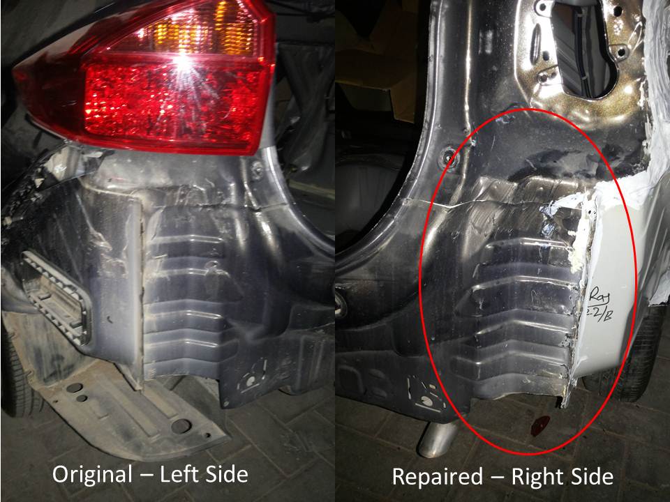

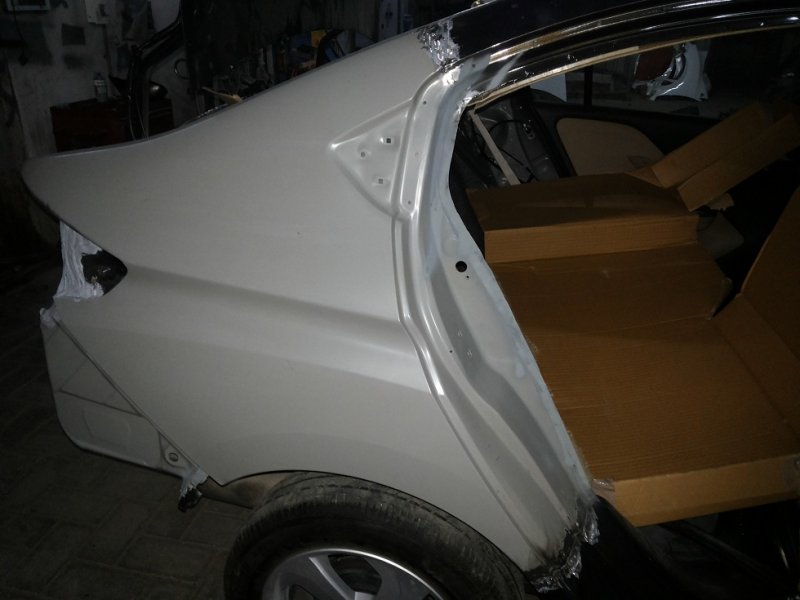

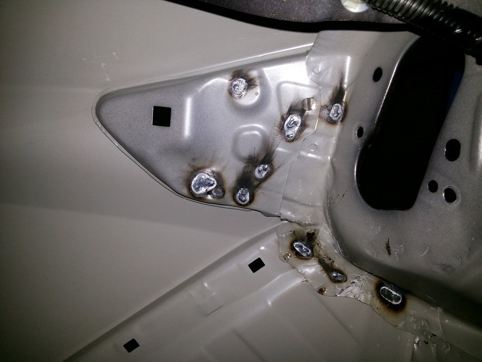

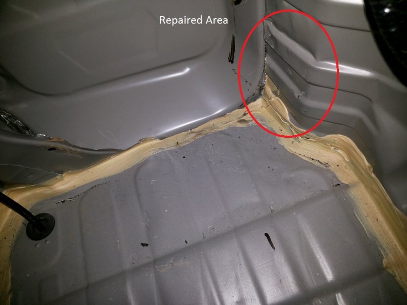

Update of Ashtra's Health Condition.
Ashtra was taken inside the ICU (Bodyshop) and she was operated. Operation was successfully completed. Still she has to be hospitalized for another 5 days to recover fully.
Any experts suggestions on quality of work. Things to check before & after the painting work. Finally after so many questions to the service advisor & body shop guys about the work, they replied, "Sir, it is all normal. We do this kind of work regularly". Surprisingly another 3 car waiting for the same work. 2 cars were completed. Finishing looks pretty decent.

It is good to know that Ashtra is recovering well and it's equally bad to see those weld spots!! Something that simply irritates me..
Gandhi, I have experienced similar situation in my earlier car. I think we owners who love their car are restive and question each and every process [:)]. For the workers it is normal work which they do day and night. I am sure Ashtra will be out of the ICU much healthier and as beautiful to look at with all job done.

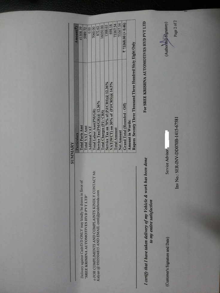

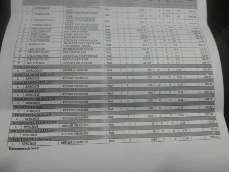

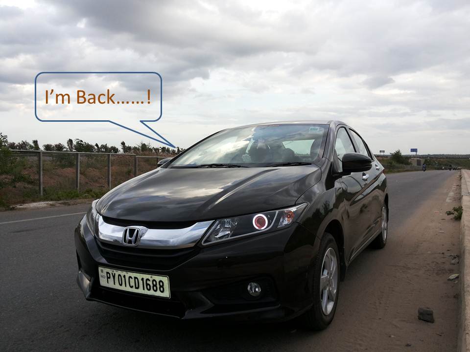

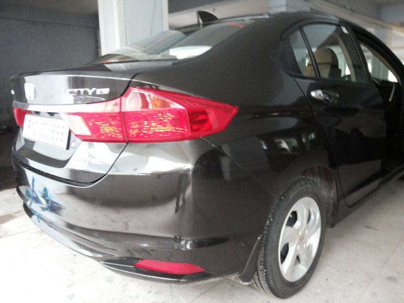

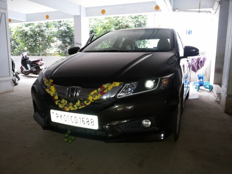

My Ashtra is back on roads for roaring [drive].
Did a pooja for my Ashtra after the hospitalization. (Personally not interested to keep these lemons, but as a sentiment keeping it for sometimes [confused]).
After 2 weeks of hospitalization, now Ashtra is back on roads.
Total Amount of Expenditure: Rs 73368.
Amount Paid from my Pocket: Rs 1573. Balance amount paid by Insurance Company.
Major Parts Replaced:
1. Quarter Panel - Driver Side - Rs 38199
2. Tail Light - Driver Side - Rs 1494
3. Rear Bumper - Rs 2948
4. Front Bumper - Rs 1991.
Painting Charges:
1. Quarter Panel - Rs 5142
2. Front Bumper - Rs 5933
3. Rear Bumper - Rs 5933
4. Rear Floor - Rs 1130
Final Output: Parts replacement, denting and painting found satisfactory.
Issues observed during Test Run:
1. Dash board rattling in Driver side near A pillar - On rough road with speed of 30KMPH.
2. Right rear door rattling (where the work executed)
3. Rear right side brake holds intermittently for some seconds ( releases after applying the brake for 2 to 3 times)
So decided to take delivery of car, and run it for few days and observe for any other issues. Then hand over it for these issues correction and 3rd Service. All the above problems will be solved with free of cost. Total time required is 3 days to diagnose and correct the issues.

Its good to see your car back in shape Gandhiji. Now a couple of questions again:
1) How is the finishing? Is it again looking the way it was or slight panel gaps are left?
2) Why is the front bumper replaced?
3) Any more squeaks or rattles?
BTW I'd advice you to take an empty road and drive with your window open and try out some sudden acceleration, braking, hard steering inputs etc at the speeds of 30-40 kph and maybe you will find some more issues.

Glad to see your beloved is back all healthy.
Aren't those painting charges a little on the higher side?
