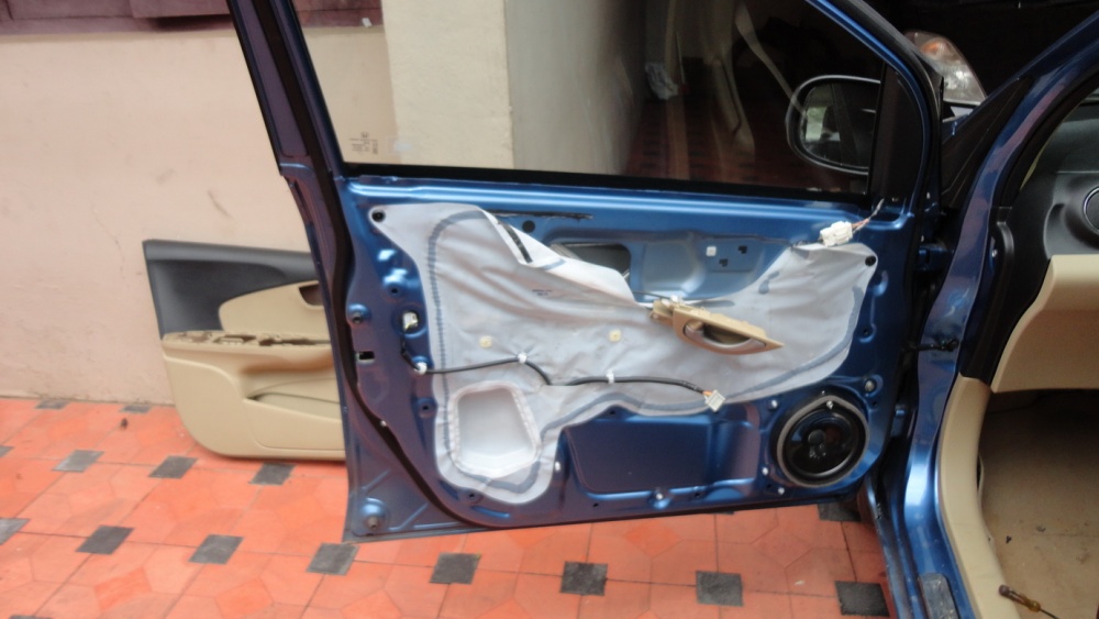

Recently felt some kind of rattling from the Left Side Door. So thought of opening up and doing a little check up !
Unscrew the star screw
Remove the Door armrest along with the power window console
Unscrew the 2 stars screw's hidden behind it
Pull out the door panel slowly
Cheap Maruti Like Plastic covering's [frustration]
Front Magnet Less Speaker's
What in the world is that Black box kept for ? [confused]
Checking the Door panel's and adding 3M tapes for a better adhesive feel
Put back the door panel's back [:D]
and the sad thing is that the Rattling still continues to persist after a few kilometer's of drive . Will be checking on the A pillar panel's soon as i have found out that the rattling come's from those panels .
