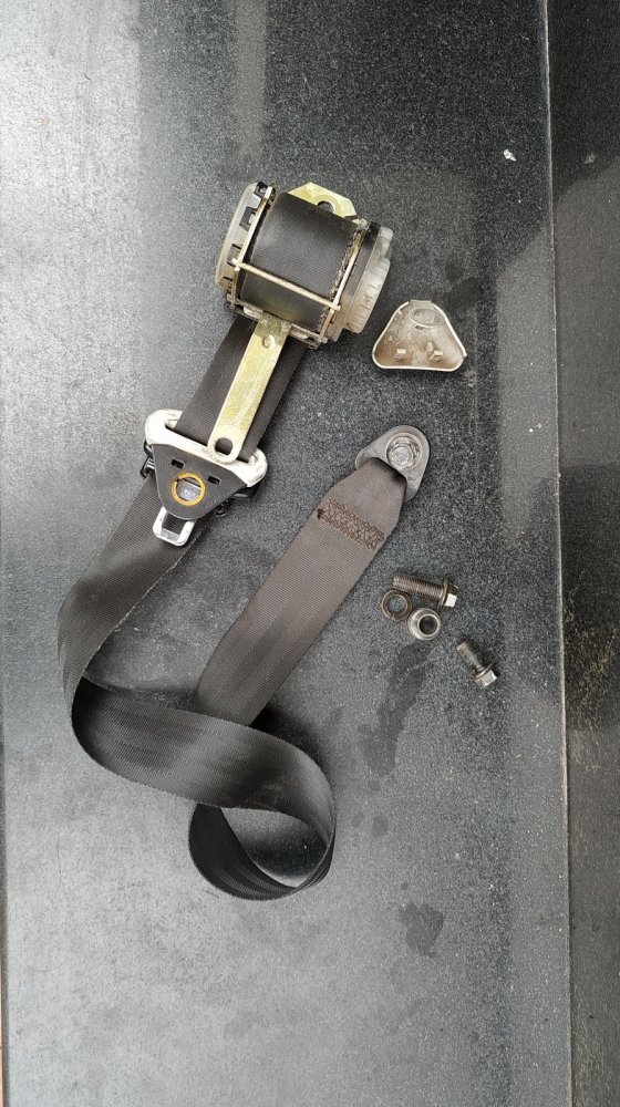

Car goes back to service. Ordered seat belt arrived and they called promptly. Installed seat belt and did silencer welding.
Bill:
RH Seatbelt - 84901M67K00-BHE - ₹ 834.00
Silencer Welding - ₹ 650.00
RH Seatbelt Replacement - ₹ 250.00
Total: ₹ 1734.00
Workshop shuttle. Gave Fiesta and took Estilo.
Belt comes as a set.
View attachment 263245 View attachment 263246
Old one. Edge was torn and gets stuck when that part goes inside the reel. Fixed by burning the edge, but was irritating when that part touches the neck.
Made by Autoliv. OEM part.
View attachment 263248 View attachment 263249
Removed buckel holder as it was moving freely, but fixed firmly.
View attachment 263250 View attachment 263251
They missed the nylon washer I think.
Added a washer.
And everything's fine.
